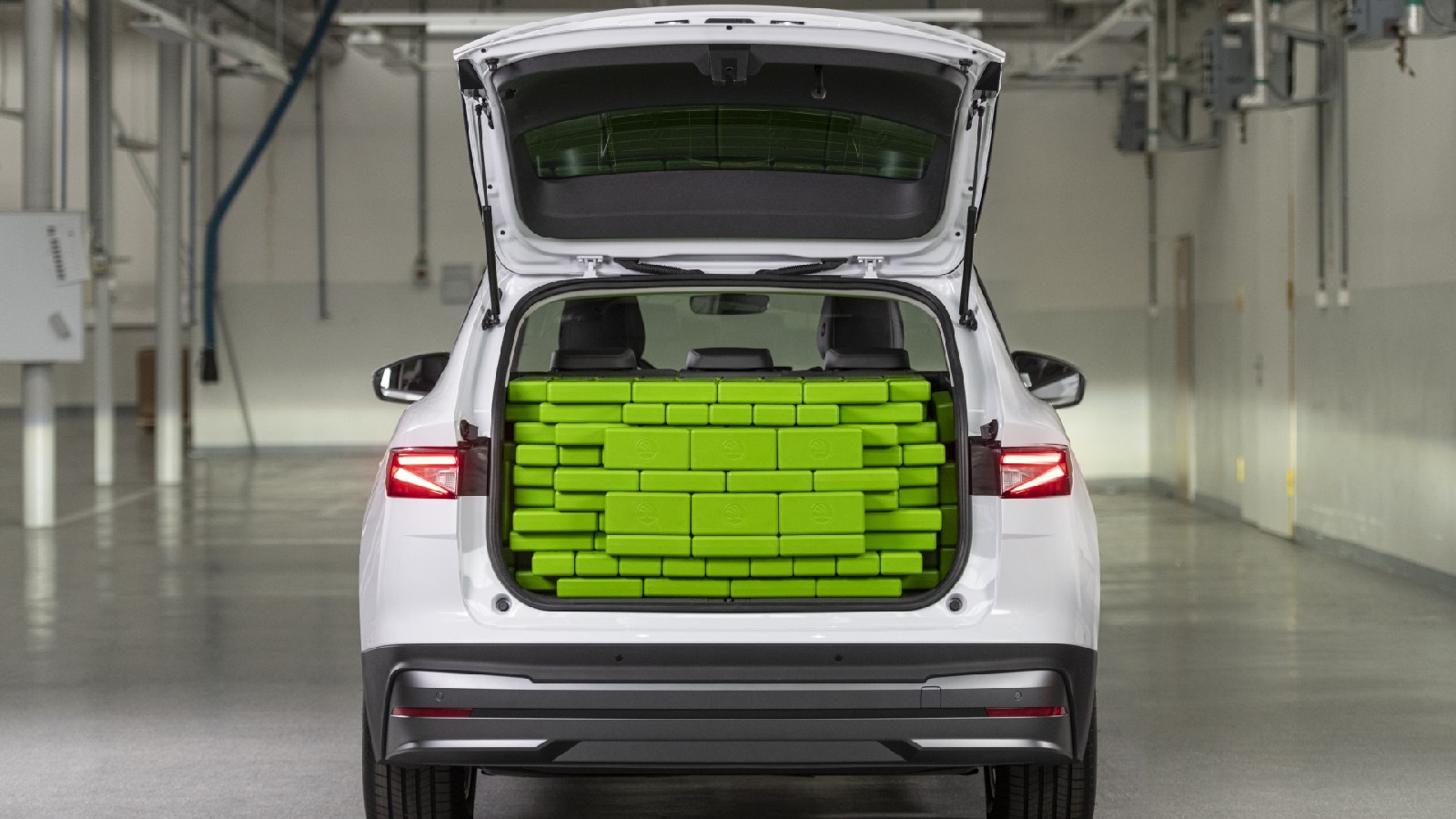

Luggage compartment space is still measured manually with the help of standardised blocks according to Skoda. Technicians arrange in the luggage compartment standardised 1-litre blocks that measure 20 × 10 × 5 centimetres. Arranging the blocks is governed by a technical standard (ISO3832). Although this may sound pretty simple, the process has its pitfalls. “What’s important is that the volume we arrive at with the blocks and then state in the vehicle’s technical specifications must be repeatable at any time,” says Ladislav Kraus, who is responsible for luggage compartment development, explaining the fundamental principle. Theoretically, then, you should be able to perform the process yourself and come up with the same figure as the technicians.

The declaration of the volume of a vehicle trunk in a catalogue is done in litres, according to standards ISO 3832 and DIN 70020. The sole measuring equipment permitted is a one-litre box (cuboid) with spatial dimensions 200×100×50 mm. The maximum number of named boxes that can be placed inside the luggage compartment without deformation specifies its volume in litres. This defines a comprehensible

“But you’d have to comply with the given rules, just like Ć KODA technicians do. For example, you’re not allowed to force the blocks in, though there is some leeway: after all, carpets and upholstery allow for a little give. The rules also dictate how far the blocks can go, depending on the version of the technical standard – you can measure the volume up to the edge of the rear seat backrests or up to the parcel shelf, which may result in large differences in different models. But the blocks must on no account raise the height of the parcel shelf” says Kraus.

Paradoxically, though, this is a tough job for a computer. “It can easily take a whole weekend to calculate. That’s because it looks for the best possible arrangement. If a block doesn’t fit, the programme tries to work out how far it has to backtrack to make optimal use of the space,” adds Peter Hancko, one of the luggage compartment constructors at Ć KODA. Arranging blocks in a 3D modelling programme will take someone about one working day. Arranging physical blocks is a question of a few hours, depending on the size of the compartment. “In real-life measurement, the technicians’ experience usually enables them to arrive at a better result than the computer, with the average improvement being around 5 litres,” says Hancko.

The technicians are genuinely capitalising on their experience, not using ‘tricks’, even though the technical standard does permit some finessing. “It is permitted to remove everything from the luggage compartment that isn’t bolted down, for example. But we don’t go that far – we want the volume to be realistic and consistent with the actual usable space,” Kraus points out. Even so, the space beneath the luggage compartment floor is included in the measurement, and when the measurement is being done with the rear seats folded down the space beneath the folded rests is counted. The technical standard allows this provided that this space can be reached after the doors are opened – it is defined as an additional luggage space.
Measuring with the seats folded down is a relatively complicated task. The front seats need to be put in the right position as well, for example. “Dummies are used to put the seat in a position defined for an average person by the technical standard. We then place a polycarbonate partition behind the seat to firmly delimit the space we can arrange the blocks in. This stops the blocks from slipping between the seats,” Hancko explains. Various other storage spaces located behind the car’s front seats are also included in the total volume with folded down seats: these include compartments in the doors, by the mudguards and so on.
