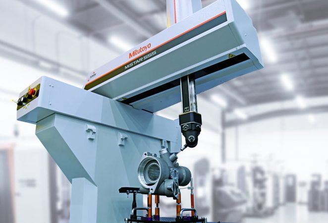

The CNC coordinate measuring machine works with I++ DME and increases productivity.

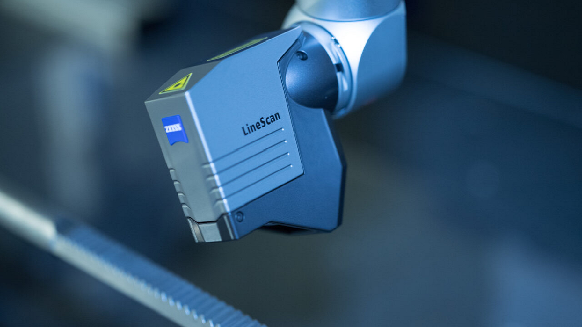

The importance of the interface version has grown significantly due to the integration of lasers required by manufacturers of measurement technology. “The amount of data generated by a line laser, for example, poses challenges for both the client and the server because the data volume increases from a few hundred to several hundred thousand points,” emphasizes Dr Thomas Maresch, Senior Product Manager System Components at Hexagon in Wetzlar, Germany. Version 2.5 also supports all sensors currently used in laser measurement systems. “And it does so from different perspectives,” adds Maresch. This is because new movement commands have been integrated into the interface, enabling the parts to be measured from different directions. This has significantly increased the amount of data which benefits quality assurance. The interface also provides information on accuracy and quality. This includes, for example:

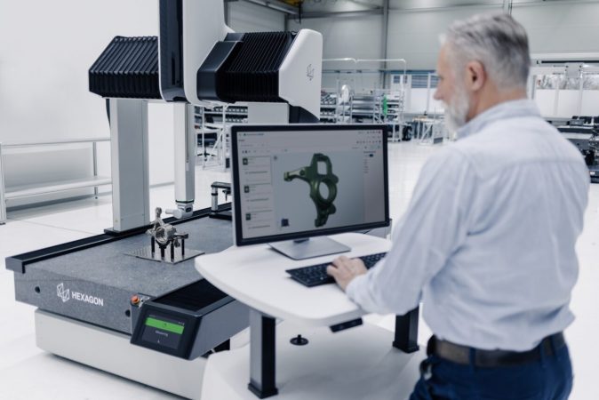

The latest coordinate measuring machine from Hexagon works with the I++ DME standard
A neutral interface divides a measurement system into a server and a client. The server controls the hardware, such as the measuring machine, the rotary table, and the measurement system. It is also responsible for calibrating the measuring systems, operating peripheral devices, and ensuring accuracy. The software (client), on the other hand, is responsible for the measurement sequence, evaluations, logging, and creating, managing and executing measurement programs. Thanks to the protocol, which defines a uniform language for the measurement commands, measuring machines and software can communicate with each other regardless of the manufacturer. This gives users greater flexibility, as even existing measurement programs become portable and can be used on different devices.
