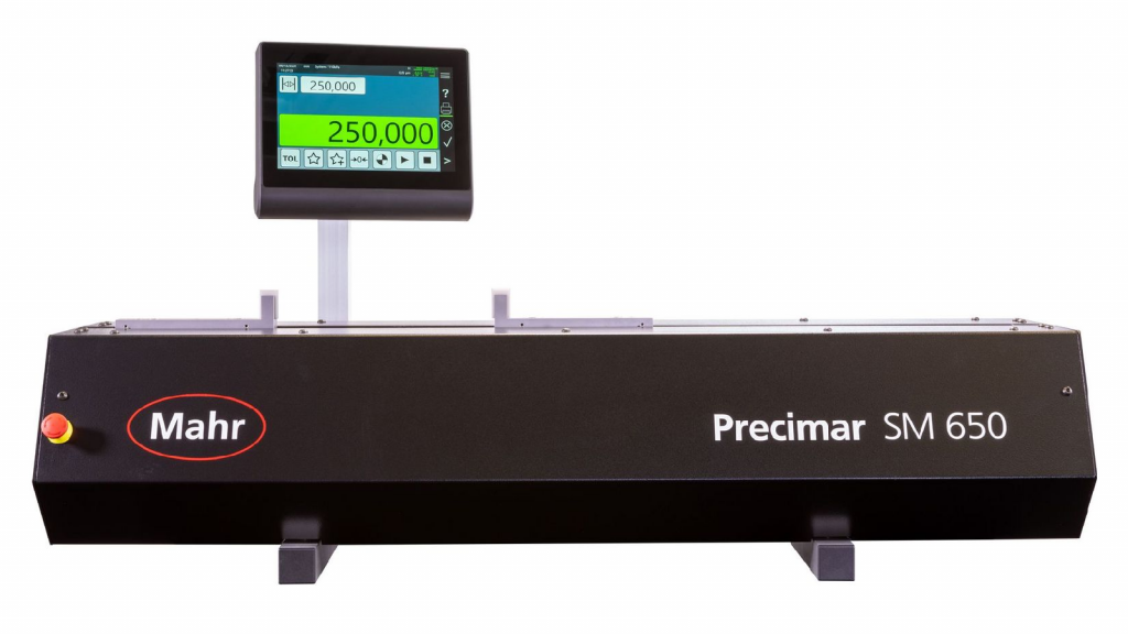

Mahr has introduced its new Precimar SM setting instrument, designed to simplify and accelerate the adjustment of measuring equipment. By automating the process, the Precimar SM eliminates the complexity of manual calibration with gage block combinations and expensive setting rings, resulting in significant time and cost savings.
Enter the desired reference value, and the Precimar SM automatically positions itself as a setting standard with the relevant dimensions.
With an exceptional accuracy of 0.7 μm + L / 1000, the device sets a new benchmark in the metrology industry, making it an ideal solution for calibrating measuring equipment such as indicating snap gages, universal measuring instruments, and 2-point inside measuring devices. Designed for production environments and available in measuring ranges of 350 mm, 650 mm, and 1150 mm, the Precimar SM is compatible with a variety of accessories for mounting different types of measuring devices. Its intuitive touch display provides straightforward operation, featuring a wide range of functions, including favorite settings for quick adjustments and barcode scanning for effortless dimension selection.
Key Advantages:
  • Save time and costs by eliminating the need for setting rings and gage blocks
  • User-friendly touch display with intuitive controls
  • No loss of accuracy compared to setting rings or gage block combinations
  • Flexible applications with an extensive range of accessories
“With the Precimar SM, we are providing a solution that not only streamlines calibration procedures but also ensures the highest levels of accuracy and ease of use in a production environment,” saidDr. Farzad Azimi, Precision Gages Product Manager at Mahr Inc. “By automating the process, the Precimar SM significantly reduces calibration time while maintaining exceptional precision standards.”
