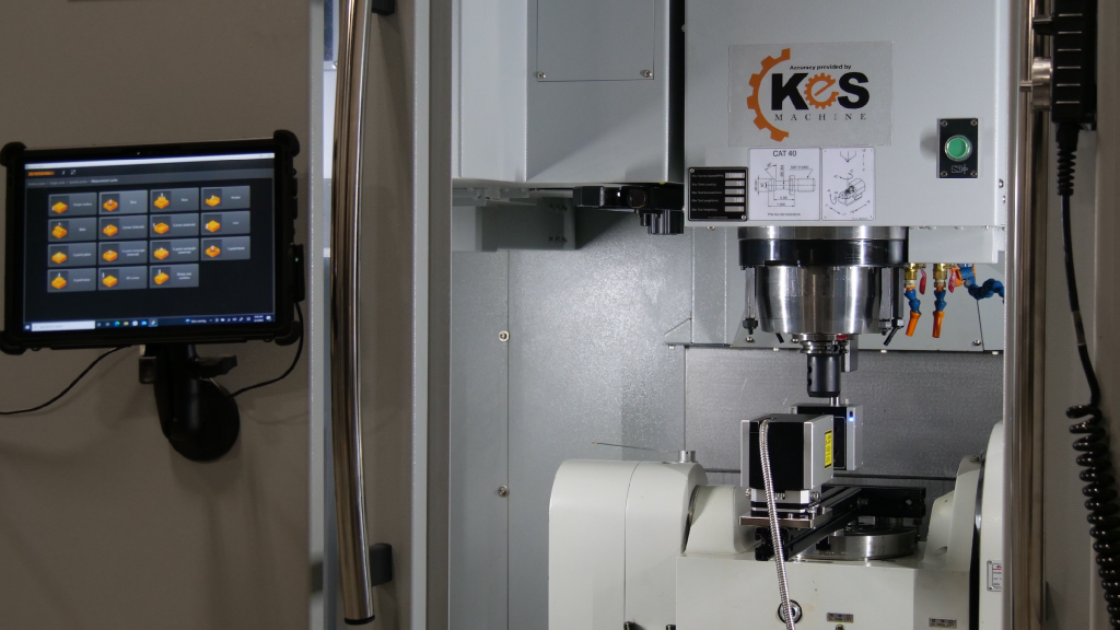

KES Machine LLC ultimately selected Renishaw’s XM-60 and XM-600 multi-axis calibrator because of its ease of use, flexibility, and ability to capture large amounts of data. KES can use the equipment on both CNC machine tools and CMMs to perform volumetric compensation. This laser measurement system is capable of measuring errors in six degrees of freedom along a linear axis, simultaneously from a single set-up. It provides a powerful diagnostic tool to measure all geometric errors in the axis from a single capture.

KES Machine used the XM-600 to implement CNC volumetric compensation and will soon offer CMM calibration to its customers, as well as support for Renishaw CMM hardware, as the XM-600 directly interfaces with Renishaw UCC controllers. For years prior to the release of the XM-60 and XM-600, KES typically used multiple pieces of different equipment to measure linear positioning, pitch, yaw and roll. The XM-60 manages this process with one pass and will include horizontal and vertical straightness over the completed travel. Measurements that used to take two to four hours are now reduced to under 30 minutes, depending on the length of the machine axis.
The equipment can also be used to diagnose machine errors. KES uses CARTO software, along with its own custom software, to simplify its processes. The KES team uses the “cut and paste” feature in CARTO software to help the compensation process and saves time using the report builder feature.
