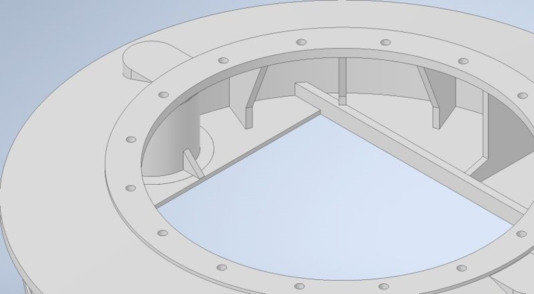

With a validated scan model established, Buffalo Metrology’s engineering team developed a fully parametric 3D CAD model. Every inspected dimension from the scan dataset informed the creation of a nominal model — effectively reconstructing the original design intent of the clarifier cover.
This step is critical in reverse engineering large industrial assemblies. Rather than replicating wear or distortion, the engineering team establishes optimized nominal geometry that reflects both functional requirements and manufacturability.
