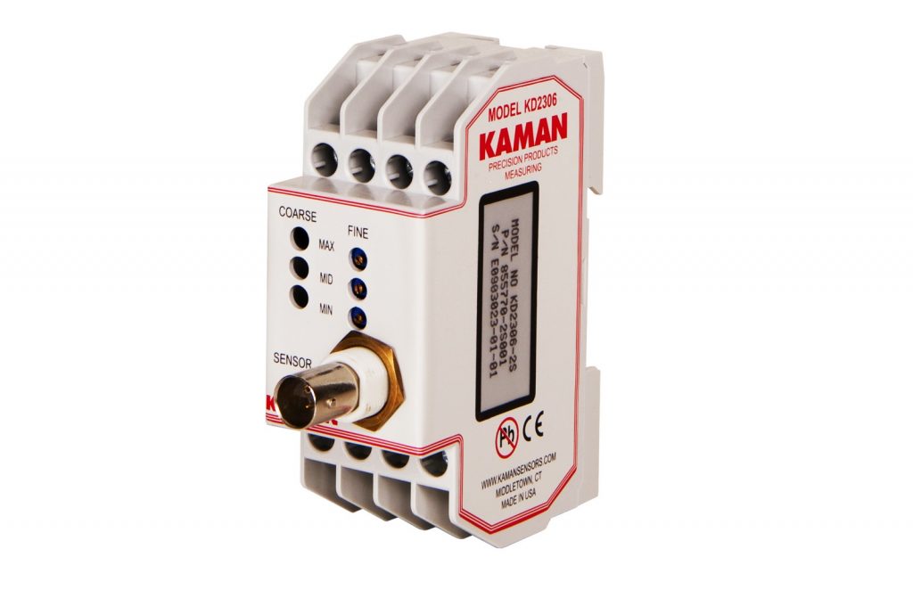

The Measuring Division of Kaman Precision Products, a leader in high-performance, non-contact position measuring systems, has highlighted its KD-2306 single-channel, multi-purpose non-contact displacement sensing system. When paired with any supported dual or single-coil sensor, the KD-2306 offers an easy-to-use, high-precision solution for both static and dynamic measurements, ideal for industrial applications.
The KD-2306 supports both dual and single coil sensors, ensuring broad compatibility and versatility. Its DIN rail mount interface simplifies integration into OEM equipment and industrial control systems. Terminal I/O connections and auto-synchronization of multiple channels facilitate system expansion, while multiple output options, including analog DC (0-10 VDC standard), 4-20mA, single-ended, bipolar, and differential voltage outputs, provide flexible connectivity to automation and control hardware. The device features front face coarse and fine calibration controls allowing precise, onsite adjustments. It meets international environmental and safety standards, being RoHS compliant and CE marked.
With a high resolution of 0.01% full scale (FS) and frequency response up to 50 kHz (-3dB point), the KD-2306 is suitable for high-speed dynamic measurements and static applications alike. It exhibits low nonlinearity of under 1% FS and thermal sensitivity compensated to as low as 0.02% FS/°F, ensuring excellent stability across varying temperatures. Factory calibration is provided with a NIST traceable certificate, while potentiometers enable user recalibration for zero, gain, and linearity. The electronics operate reliably within a temperature range of 0°C to +55°C and can be stored safely between -55°C and +105°C.
The system offers extensive customization options such as extended sensor cables, special calibration ranges, temperature compensation (including cryogenic applications), and custom sensor designs. Accessories including power supplies, micrometer calibration fixtures, and ceramic calibration spacers allow further tailoring to specific needs. Additionally, treatments like microseal moisture resistance enhance durability.
Ideal as a cost-effective alternative to traditional displacement devices like LVDTs, air gauges, dial indicators, and micrometers, the KD-2306 excels in OEM machine control, industrial automation, production process monitoring, quality control, as well as laboratory and research measurements. It delivers reliable, non-contact, and maintenance-free displacement sensing even in demanding industrial environments.
