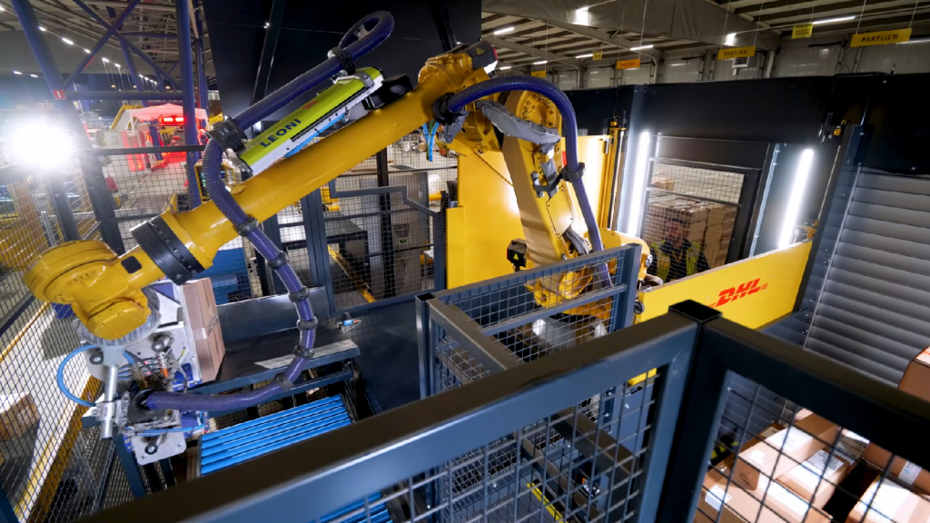

At DHL eCommerce in Rotterdam, RODE processes up to 800 parcels per hour with a maximum weight of 31.5 kg each and places them on the corresponding sorting belt. The particular difficulty here lies in the robot’s picking of parcels of different sizes and weights. It must independently recognize the position of the objects in three-dimensional space and decide which package to pick next. It then has to determine the best gripping position and avoid collision with other parcels or the machine.
“This intelligent robotic solution integrates AI image processing and high-tech gripper technology. The system recognises products and can flip the items to ensure that the required long side is leading,” explains Sander Lensen, R&D Manager at AWL. Two Ensenso X36 3D cameras provide the necessary image data. They are able to provide robust 2D and 3D information on products on a pallet measuring 1200 x 1200 mm and a maximum height of 2400 mm. The integrated image processing system processes this further and enables the depalletiser to identify each individual package and determine the corresponding gripping position – for robust robot-assisted picking.
