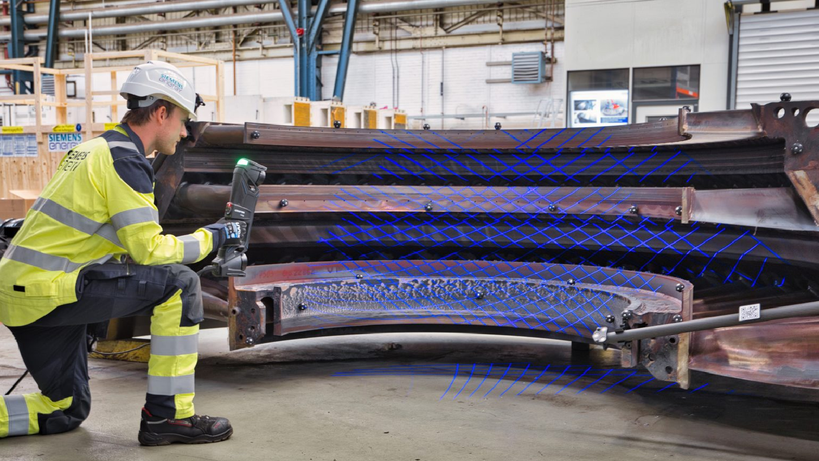

Siemens Energy employs 3D scanning technology at its factory in Germany to validate the quality of parts it produces or those it receives from suppliers. The company also deploys its expert teams on-site to replace old, worn components, such as turbine rotors. By conducting thorough facility scans and precise measurements, they can reverse engineer replacement parts to ensure seamless integration with existing systems. Moreover, Siemens Energy goes beyond mere replacements by designing new parts that enhance the energy efficiency of power plants, contributing to both improved performance and environmental sustainability.

Quick Measurement of Large Parts: With the HandySCAN 3D|MAX Series, the on-site maintenance and repair teams can scan large
parts, as big as turbine rotors measuring up to 14 meters, in fine detail. Compared to the old system, whose setup and acquisition were long and complicated, teams can now scan more parts while saving time. The speed of the acquisition process makes all the difference because it enables Siemens Energy to limit downtimes during part replacement. Customers save money by saving time because every hour a power plant does not operate is an hour it cannot earn money.
Flex Volume for High Resolution and High Speed: The MAX Series presents the Flex Volume feature, which gives Siemens Energy the flexibility to scan large parts at high speed from a longer distance (Far Mode) or measure smaller areas with high resolution at a short distance (Near Mode). The teams can also use the standard mode to benefit from both speed and resolution when scanning valves and connectors. This combination of speed and resolution allows them to quickly capture all the small details and ensure everything fits in its proper place on the first try during installation.
Portable Everywhere: Siemens Energy provides repair and maintenance services directly to power plant locations. On-site, the teams handle large and difficult-to-move parts in environments with high temperatures and steady vibrations. With the HandySCAN 3D|MAX Series, Siemens Energy can now perform all measurements and tasks with a single reliable device that is easily transportable and adapted to the instabilities of industrial environments.
Better Versatility for More Simplicity: Siemens Energy is particularly fond of the Smart Surface Algorithm feature, which automatically adjusts the camera shutter using advanced image processing combined with artificial intelligence. This feature enhances the performance of the MAX series and provides better readings of difficult contrasting finishes. As a result, anyone can enjoy a simpler and more straightforward scanning process, regardless of their level of expertise or experience.
