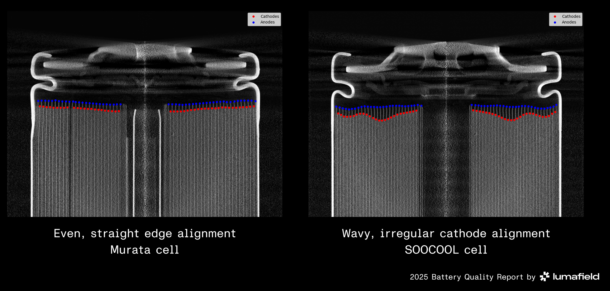

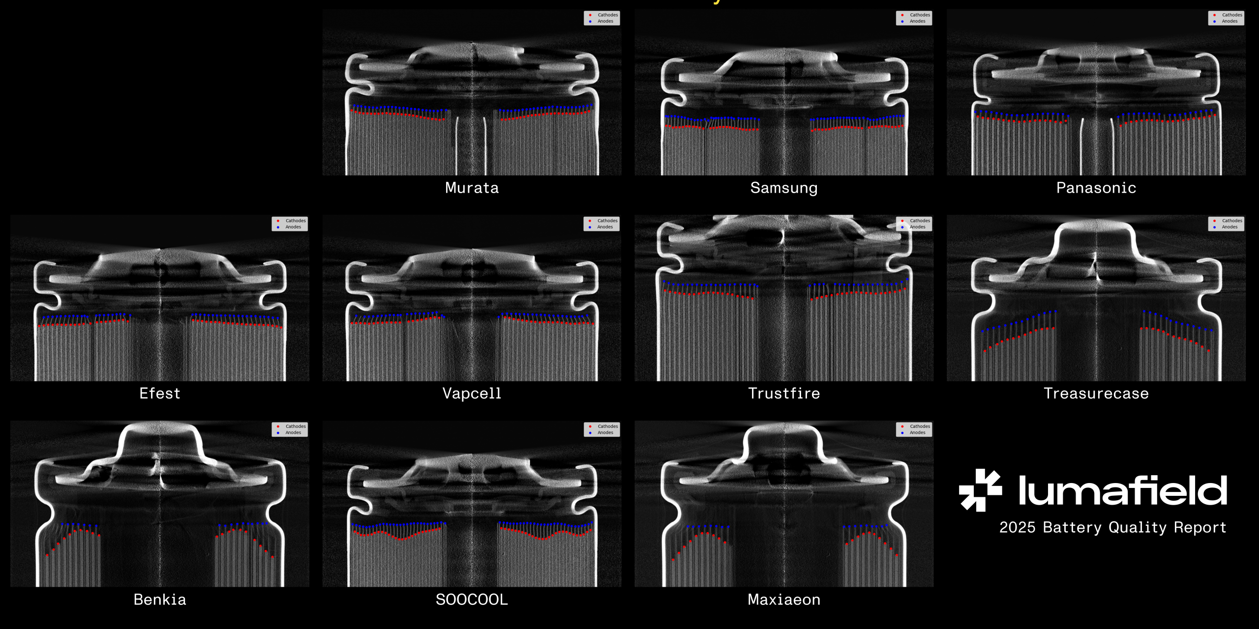

To study the quality of 18650 cells, Lumafield used Ultra-Fast CT scanning on a sample of more than 100 cells from each of ten different brands, ranging from high-quality OEMs to outright counterfeits. The results show clear, measurable indicators of risk in non-OEM 18650 cells.
Key findings include:
- Of the 1,054 battery cells scanned, 33 had negative anode overhang, a manufacturing defect that accelerates aging and significantly increases the risk of internal short-circuiting and battery fires.
- All 33 of the defective cells came from low-cost or counterfeit brands, meaning one in 13 (nearly 8%) low-cost/counterfeit batteries could have this dangerous defect.
- One low-cost brand acquired through Temu had a 15% rate of negative anode overhang defects—a serious risk to consumers who may be tempted to acquire inexpensive batteries through the marketplace.
- On other measures of cell quality, low-cost/counterfeit batteries are seven times worse than their OEM counterparts.
- Low-cost/counterfeit 18650 cells had 50% worse edge alignment—referring to the winding of the internal layers of the cylindrical battery—compared to OEM cells. This represents yet another quality concern that can cause performance degradation and internal short circuits.
- None of the 300 brand-name OEM cells from Murata, Samsung and Panasonic suffered from negative anode overhang, suggesting that batteries from these high-quality manufacturers sourced through legitimate retail channels are the safest and most reliable cells.

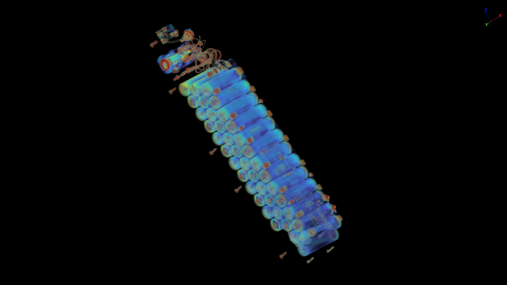

- The risks in individual cells are compounded by the fact that many products include multiple 18650 cells—from 5 in a typical cordless drill to 39 in an e-bike battery pack that Lumafield CT scanned for the study.

To develop this study, Lumafield used Ultra-Fast CT technology to scan more than 1,000 batteries, sampling at least 100 cells from 10 different brands that ranged from high-quality OEM to low-cost counterfeit. After scanning, Lumafield used its Battery Analysis Module to automatically capture quality metrics for each battery. The evaluation focused on the two main indicators of cell safety and quality—anode overhang and edge alignment—evaluating these metrics within and across each of the brands.
