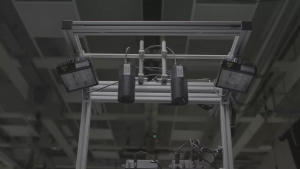

Above Image: Zero-defects manufacturing: Composite image showing a door panel inspection test bench. GigE industrial cameras (seen here in bottom left of image) deliver numerous images that are processed within a half second to determine product conformity. (Image courtesy of ITgroup)

In the past, trained technicians performed visual inspection for defects such as scratches, dents, or misalignments. Given manual inspection’s slippage rates of 20% or more and the increasing complexity of subassemblies, however, automated visual inspection offers the most effective method of moving toward a zero-defects goal. ITgroup’s standard door panel inspection systems use three DFK 33GP006 (5 MP, rolling shutter) GigE cameras and one DFK 33GX183 (20 MP, rolling shutter) GigE camera. Mr. Troniarsky reports that the test benches deliver a “pseudo error rate false positive < 0.1%, false negative 0% (in total over 100 different test characteristics) with zero instances of end-customer complaints.”
