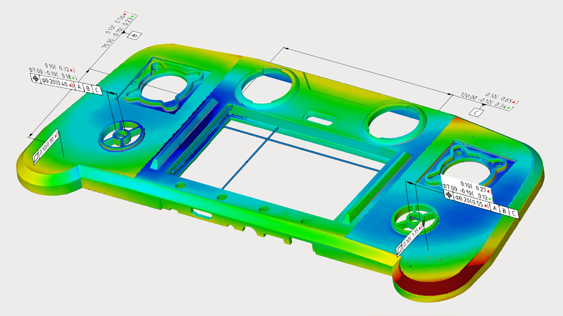

Both GD&T and the measuring results of the tolerance check are expressed as pure numerical values. However, interpreting these numbers and translating them into specific corrective actions is a challenge: The numbers contain neither information on the orientation in which the inspected part element may need to be corrected nor what quantity of material must be removed or added at which location. They merely reflect the width or diameter of the computed tolerance zone. For this reason, graphical representation methods, e. g., in the form of deviation flags, have been established to visually identify the type and form of deviations. These can also be supported by indicating deviations in individual axes. GD&T is most easily inspected using software that color-codes nominal and actual values and uses vectors to represent deviations.
