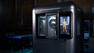

ZeroTouch Rotational (ZTR) Metrology System
In contrast, DWFritz’s ZeroTouch metrology and inspection platform uses 3D scanners that measure the brake disc in a single inspection process lasting just a few seconds while the analysis software creates a digital twin based on the measurement of millions of data points. The system can be integrated directly into the production line and can operate without much intervention, eliminating time-consuming loading and unloading processes.

ZeroTouch metrology and inspection platform uses 3D scanners that measure the brake disc in a single inspection process lasting just a few seconds while analysis software creates a digital twin based on the measurement of millions of data points.

So how can the precision of the inspection process be optimized while reducing the time and effort required? DWFritz Automation, a U.S.-based developer and manufacturer of equipment for automated, high-speed non-contact inspection, has adapted its ZeroTouch measurement platform specifically for the inspection of brake discs. The ZeroTouch Rotational (ZTR) Metrology system checks all relevant parameters in a single inspection process and can be integrated directly into the production line with an optimal footprint. All process steps can be automated, including the loading/unloading of the part into ZeroTouch. The brake disc is loaded into the system by a pneumatic loader, gantry system, or by a robot and is positioned on the measurement platform. This platform rotates as multiple sensors scan the brake disc from various sides during the measurement process. ā€In order to be able to check the brake discs as precisely as possible for defects, we use up to 6 strategically positioned non-contact sensors,ā€œ explains the company. ā€These scan the brake disc and create a 3D model accurate to the micron within just 20 seconds, based on the measurement of millions of data points.ā€œ
Industry-proven analysis software then compiles an accurate 3D model of the brake disc based on the measurements from the individual scanners. This is checked in real time for geometric errors or defects on the surface by comparing the test object with a reference model. During this process, flatness and parallelism, or waviness, are checked, and even deeper damage is reliably detected. The very precise measurement process also ensures that dust particles, for example, are identified to eliminate confusion with superficial defects, which reduces false alarms. If there are excessive differences between the nominal and actual values, the system issues a warning and automatically sorts out the defective part, thus reducing the probability of installing a faulty brake disc to virtually zero.
