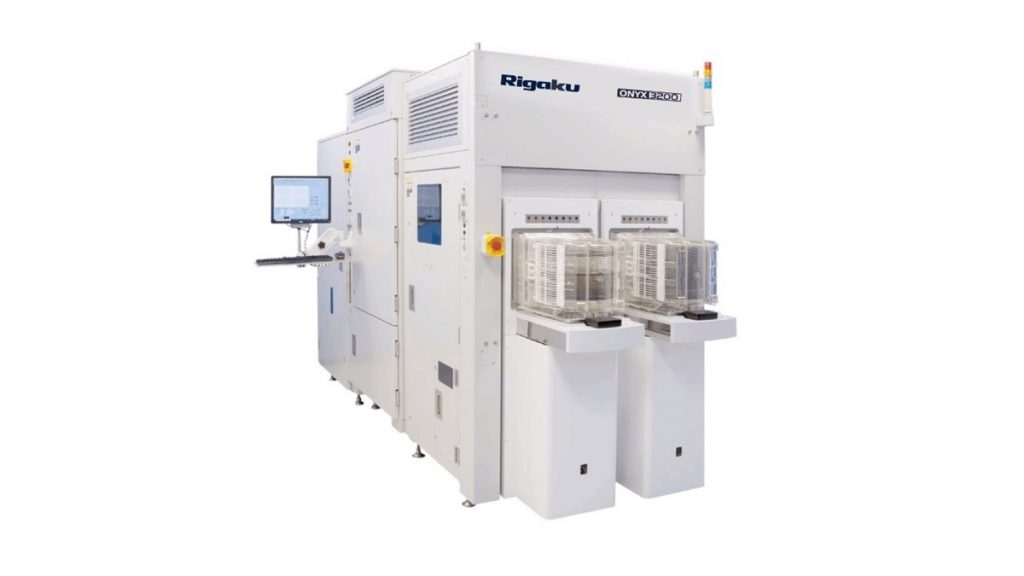

Rigaku Corporation, a solution partner in X-ray analytical systems has announced the launch of the ONYX 3200, a new semiconductor metrology system to measure film thickness, composition and bump* structures for wafer-level processes. The system is engineered to help manufacturers stabilize quality and increase yield in the metal-wiring formation (back-end-of-line (BEOL)) and packaging processes of semiconductor chips. The ONYX 3200 is an advanced hybrid metrology solution with its dual head which combines advanced μXRF and optical techniques to provide high accuracy in defect detection and the highest throughput for in-line semiconductor manufacturing.

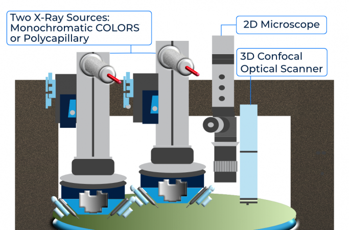

High-Precision Bump Metrology Using a 3D Confocal Scanner: The ONYX 3200 can inspect the shapes and heights of microscopic bumps and electroconductive metal patterns in 3D with high precision. Bumps consist of lower layers of copper, nickel, or similar materials beneath an upper layer of tin and silver. Conventional metrology methods result in absorption by the upper layer, making simultaneous measurement of upper and lower layers impossible. The ONYX 3200 integrates an optical scanner to capture the overall bump shape and total height and a fluorescent X-ray detector which is used to measure the upper metal layer thickness. Subtraction of these values enables precise calculation of the lower metal layers, establishing a baseline for ensuring robust interconnect reliability.
Original Dual-Head Microfocus X-ray Source: The ratio of materials in a tin-and-silver (SnAg) bump has significant impact on the reliability of packaging connections. Rigaku has developed a unique, dedicated X-ray head capable of detecting silver content as low as 2% within SnAg bumps with an exceptional precision of 4 parts per 100,000 providing rigorous materials ratio control for packaging yield. Moreover, the dual-head architecture enables simultaneous measurements of the wide range of metal features around chip interconnects, improving throughput and analytical flexibility.
