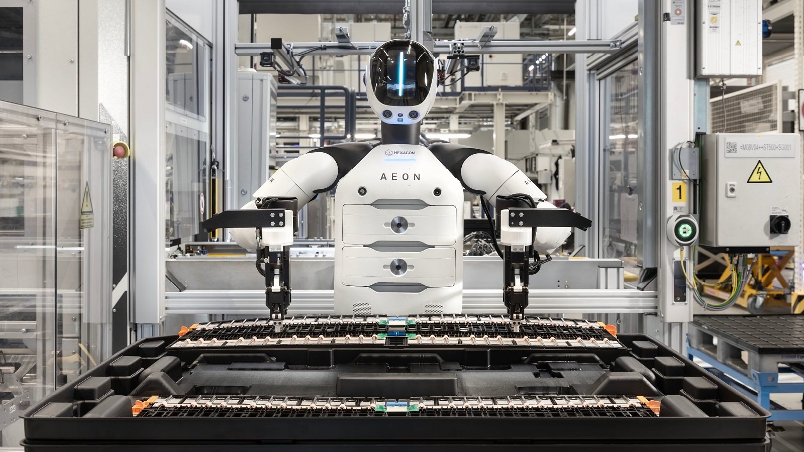

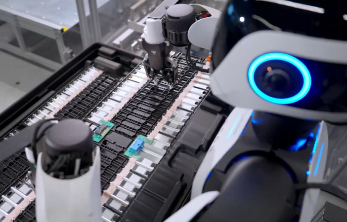

In collaboration with Hexagon, a long‑standing, established partner of the BMW Group in the field of sensor technology and software, the first pilot project in Europe is now underway. Hexagon Robotics, specialises in Physical AI and presented its first humanoid robot, AEON, in June 2025. Following an initial theoretical evaluation phase and successful laboratory tests, there was an initial test deployment at BMW Group Plant Leipzig in December 2025. A further test deployment is planned from April 2026 to ensure full integration for the actual pilot phase starting in summer 2026.
The deployment in Leipzig is focusing on testing a multifunctional application of the robot. It is based on AEON’s design, whose human‑like body allows a wide range of hand and gripper elements or scanning tools to be flexibly attached and enables dynamic use on wheels. During testing and later in the pilot phase, the robot will be used in the assembly of high‑voltage batteries and in component manufacturing.
