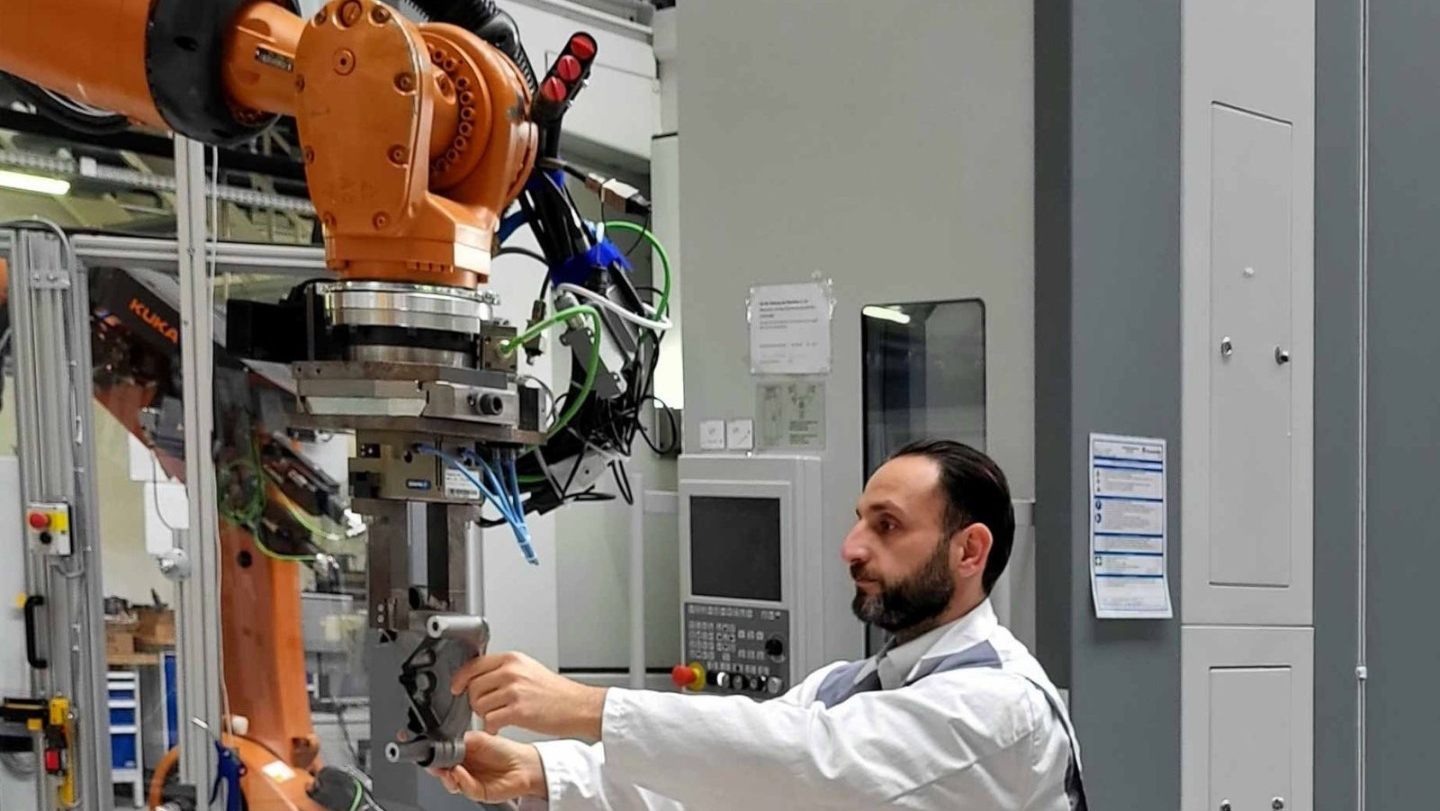

Robotics technology that not only performs simple tasks but also supports humans in all their tasks is among the key technologies in industrial manufacturing. But this requires that robots be able to master complex movements, execute commands and maintain a safe distance from humans at all times. Fraunhofer researchers have now made this form of collaboration between humans and machines possible in the NeurOSmart flagship project.

NeurOSmart was coordinated by Fraunhofer ISIT. “Together with our project partners, we have further developed the technologies and integrated them in an overall system. Collaboration with the machine is risk-free for humans,” says Shanshan Gu-Stoppel, Head of Optical Systems at Fraunhofer ISIT and honorary professor of microtechnology at the FH Westküste University of Applied Sciences in Heide.

Fraunhofer IAIS is developing the highly specialized AI models required for this. Only a few milliseconds elapse between signal reception, evaluation and the mechanical response of the robot arm. This enables safe collaboration even with heavy-duty robots, which the AI slows down or stops when a person comes too close. By simulating the entire robot cell, Fraunhofer IAIS was able to simulate hazardous situations for training purposes that cannot be replicated in real life.
