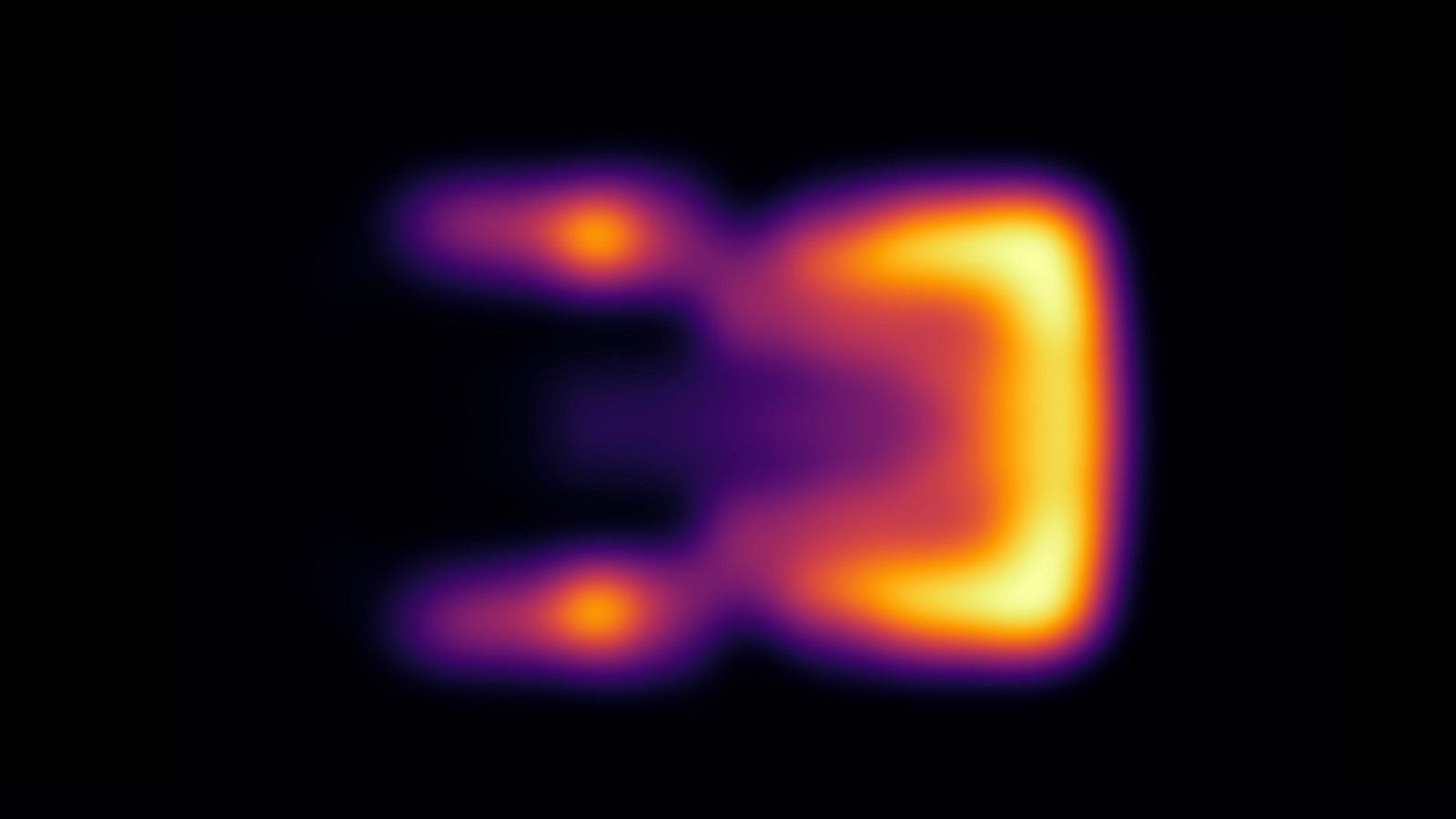

Previous studies have shown that even simple beam shapes with rectangular, ring-shaped or a combination of two Gaussian distributions produce promising results for both component quality and process speed. The potential of more complex beam shapes has so far been largely unexplored, as the necessary system technology was lacking. This is now changing thanks to the comprehensive investigations that researchers at Fraunhofer ILT have begun.
“The interaction of laser beam and material in the process is so complex due to its dynamics that simulations can only provide indications of the actual melt pool behavior,” explains Kippels, who is currently setting up a new type of system that uses LCoS-SLMs (Liquid Crystal on Silicon – Spatial Light Modulator), which will enable researchers to investigate almost any beam profile in the LPBF process.
As it has a laser power of up to 2 kW, the innovative system is a platform for testing new beam shapes at very high power levels in the LPBF process, which allows the suitable system technology to be identified for an individual LPBF task. “We can optimize the LPBF process in a targeted manner,” explains Kippels. He refers specifically to less material evaporation, less spatter formation, reduced melt pool dynamics, smoothened melt track surface, and increased process efficiency by adapting the melt track geometry.
