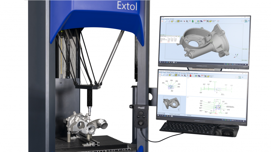

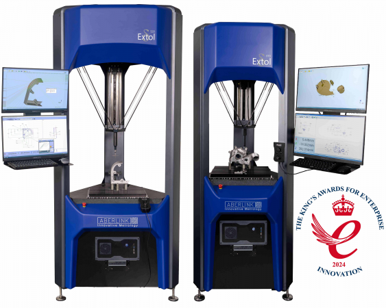

The Extol Advantage: Designed for the Shopfloor
Unlike traditional CMMs that demand a temperature-controlled inspection room, the Aberlink Extol has been purpose-built for the shopfloor environment. Its ultra-stable construction and advanced thermal compensation system allow it to deliver reliable accuracy even in fluctuating factory conditions.
Key technical highlights include:
Measurement Volume: Available in sizes up to 1000 x 1000 x 600 mm, making it versatile for a wide range of components.
Accuracy: Accuracy: Typical volumetric accuracy in the 2–3 micron range (depending on configuration and size).
Construction: A granite base and linear guideways provide rigidity and long-term stability.
Sensors & Probing: Compatible with both touch-trigger and scanning probes, enabling high-speed measurement of complex geometries.
Automation-Ready: Native integration with Aberlink 3D’s automation suite makes it ideal for robotic loading, in-line inspection, and adaptive manufacturing cells.
Thermal Stability: Real-time temperature compensation ensures measurement integrity in non-controlled environments.
These design principles make the Extol not just a measurement tool, but a process enabler for next-generation manufacturing systems.
