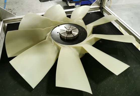

The implementation presented substantial technical challenges: the manufacturer operated without automated fan inspection capabilities, while the product geometry—with diameters reaching 800 millimeters – demanded a vision system configuration capable of capturing exceptionally large fields of view without compromising measurement precision.

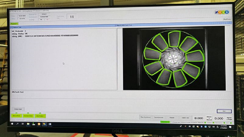

Upon placement, the vision system initiates fan inspection by acquiring the data matrix code located on the black-painted metallic hub component. This 2D barcode contains model-specific parameters that the vision system decodes and transmits to the manufacturer’s PC-based supervisory control platform, which responds by retrieving the corresponding tolerance specifications and target values for that particular fan assembly variant.
The system then executes a comprehensive geometric validation protocol. Primary inspection criteria include blade count verification and dimensional analysis of individual blade geometries. Critical to fan performance characteristics, the vision system detects material anomalie – including flash from overmolding and material voids – with a measurement tolerance of ±1.0 mm, ensuring that even minor manufacturing defects are flagged before balancing operations.
Measurement data undergoes real-time comparison against the retrieved target parameters. Components meeting all specifications advance to static balancing procedures before shipment to OEM customers for engine integration. Non-conforming units trigger automated rejection, with disposition routing based on defect classification: marginal deviations are directed to rework operations, while out-of-specification components are scrapped to maintain quality integrity throughout the supply chain.
