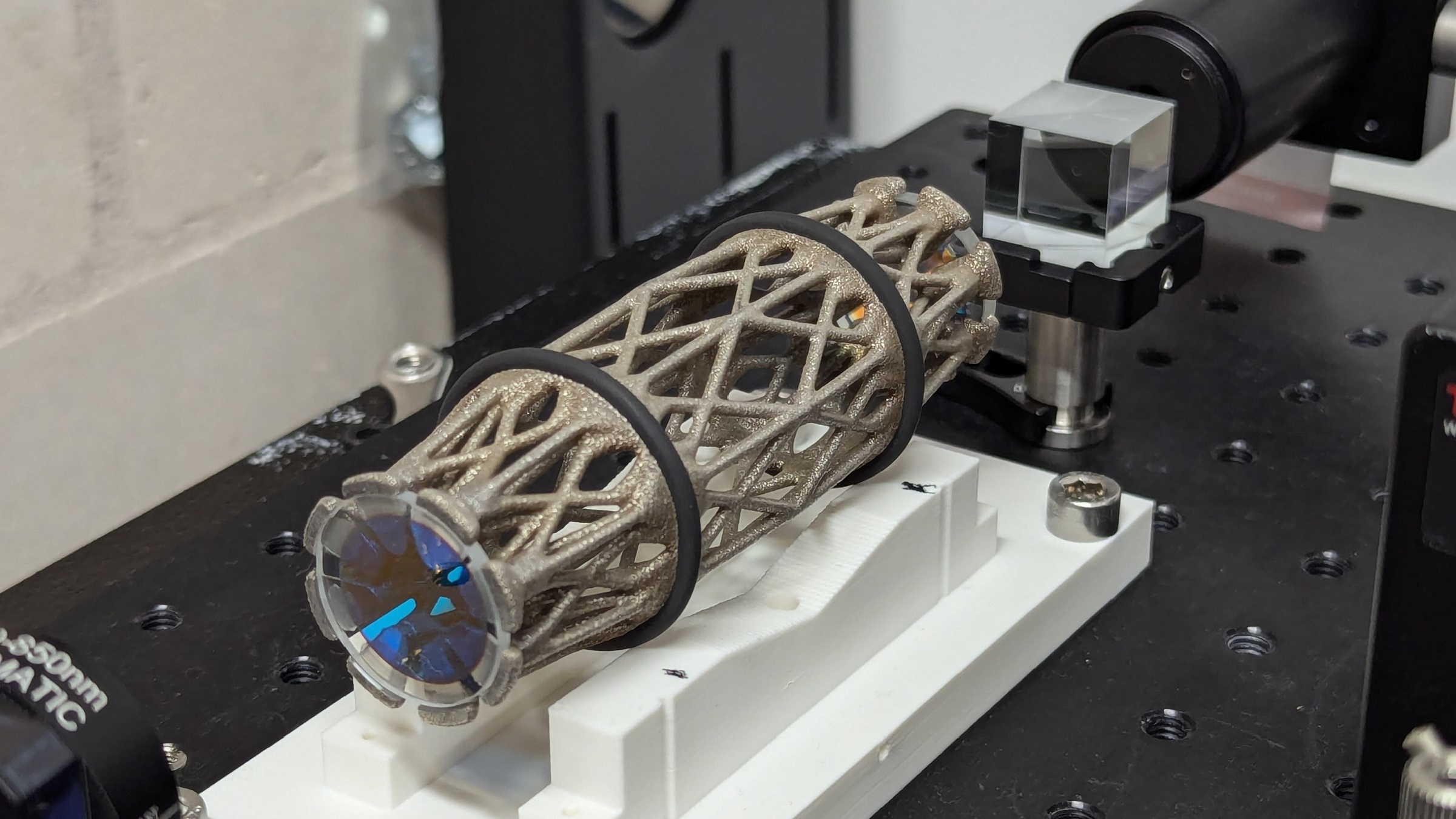

Too often, AM design celebrates complexity for complexity’s sake. Lattice-filled parts, organic surfaces, and biomimetic forms might look impressive, but without functional justification, they are little more than digital art.
Purposeful complexity, on the other hand, emerges from performance needs:

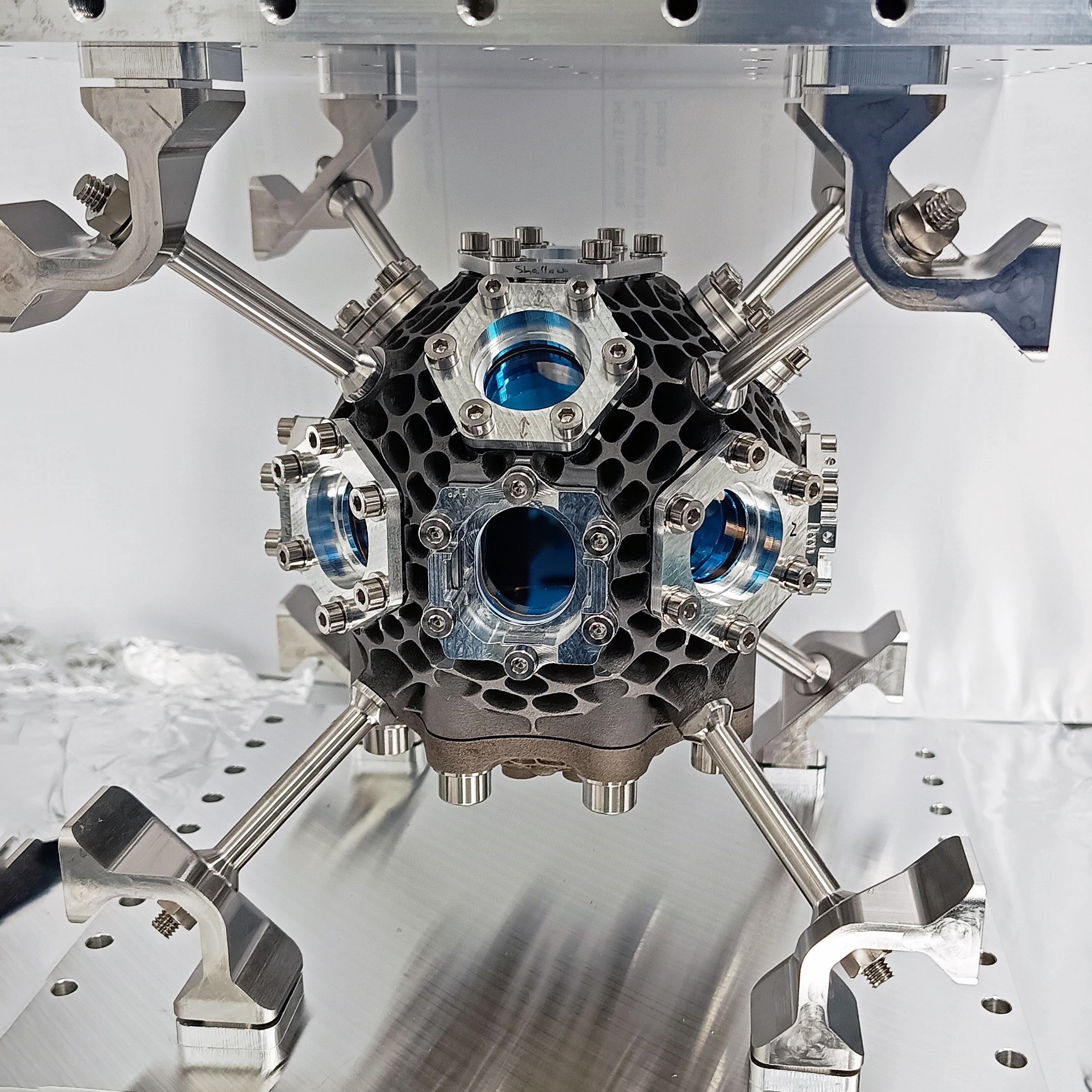

When you factor in deviation, form isn’t just adjusted after the fact, it’s engineered from day one. Critical features are deliberately positioned in regions we know will experience lower deviation, while geometry types are selected to minimise the risk of distortion. Even build orientation and chamber dynamics (such as scan strategies or wiper blade direction) are considered in the earliest stages of design. In this way, deviation isn’t treated as an inconvenient afterthought but as a fundamental design parameter, shaping where features go and how they behave once built.

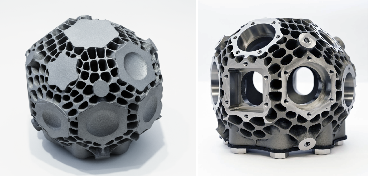

Metamorphic has demonstrated how AM-derived designs can be adapted for processes, among others, like investment casting, without losing the performance benefits. This is where Designing for Deviation is particularly powerful, because transferring a geometry from AM to a traditional process introduces a whole new set of deviations to consider.
By designing with these in mind from the start, we can take a complex AM-optimised geometry and reproduce it faithfully in high-volume processes, bridging the gap between innovation and industrialisation.
