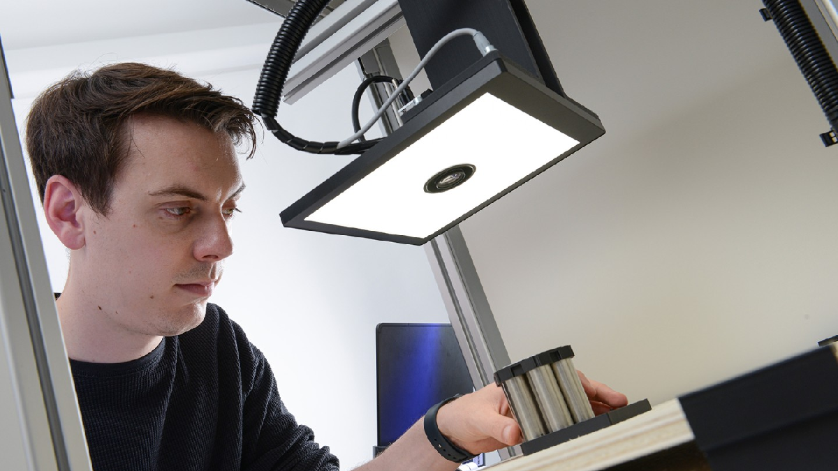

The use case that the researchers will be demonstrating shows the automated detection of defects in weld seams on battery cell modules. To do this, the battery cell module is manually placed under a camera and a photo is taken, which is then analyzed by a pre-trained deep learning model. During ongoing production, the artificial intelligence independently detects defects what would otherwise have to be identified by trained specialists. The new system, on the other hand, immediately displays the defect detection in color in real time â red for a defective product and green for a flawless product. This allows defects to be detected during the production process and rejects to be avoided at an early stage.
The system specifically inspects battery cell modules, but it can also be applied to numerous other products that require a visual surface inspection. The process increases production efficiency through consistent and objective quality assurance and relieves skilled workers of this routine task. By automating the inspection process, companies can also counter future staff shortages.
