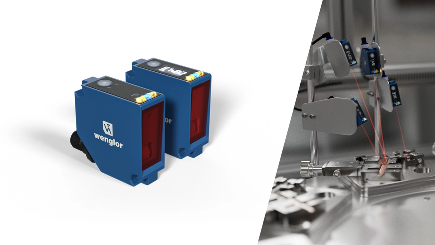

The wenglor sensoric group’s new P1PC series offers a cost-effective alternative to its established P3 sensors, providing high-precision laser triangulation distance measurement across a wide range of industrial applications. Designed for flexibility and stable performance, the P1PC series ensures reproducible results and maximum process reliability, even in high-volume production environments. Its efficient design makes it an ideal solution for precise measurement tasks while optimising resources.
Intuitive Operation and Seamless Setup
Like the P3 series, the P1PC sensors emphasise ease of use. Configuration is handled wirelessly via NFC using the weCon app, while the integrated 7-segment display delivers real-time distance readings for immediate monitoring and control. The sensors’ IO-Link 1.1.4 interface provides full access to measurement data, enabling advanced process integration. With a measuring rate of up to 2,500 measurements per second, the P1PC series guarantees high precision even in fast, dynamic processes. Additional functions, including integrated jump detection and intensity evaluation, expand application versatility.
Reliable Object Detection Across Materials and Surfaces
The P1PC series excels in stable object detection and high repeatability, delivering consistent measurements regardless of object color, brightness, or reflectivity. This makes it suitable for dark, light, or low-reflective surfaces. Its compact 1P format and comprehensive product portfolio support flexible integration into high-volume production machines. Optional accessories, such as protective glass, dust extraction tubes, or stainless steel housings, combined with a robust plastic design, ensure reliable performance even under demanding industrial conditions.
Key Features at a Glance
- Integrated 7-segment display for real-time measurement feedback
- Wireless NFC configuration, even in installed or de-energised state
- High-speed measurement up to 2,500 readings per second
- Advanced functions: jump detection and intensity evaluation
- Standardised 1P format for easy system integration
The P1PC series demonstrates how high precision, intuitive operation, and resource efficiency can be combined in a compact, reliable laser distance sensor for modern industrial applications.
