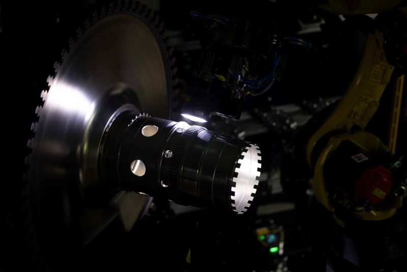

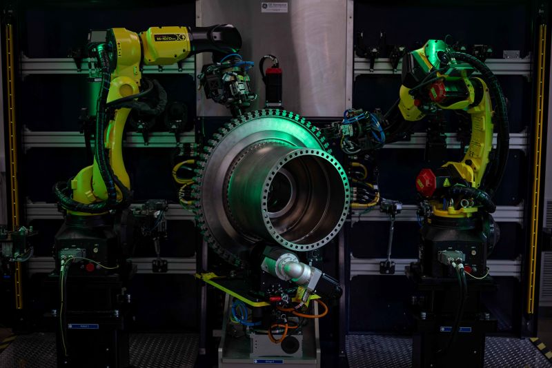

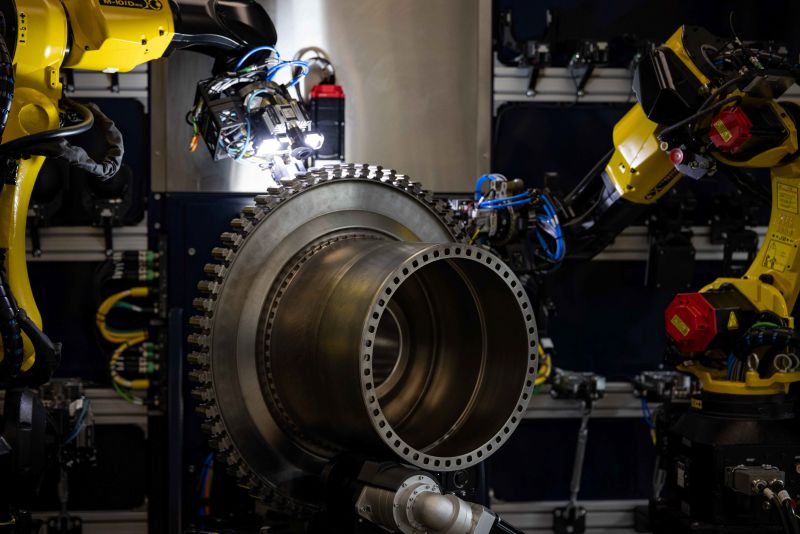

Standing in a universal workstation, two articulated industrial robots outfitted with white light optical scanners move closely over the entire surface of the high-precision part — in this case, a turbine disk for a GE90 engine. Like two ballroom dancers, the robots’ movements are carefully choreographed by human operators and use AI to capture and analyze data with optimal accuracy, speed, and consistency, simultaneously creating a digital record of each part’s condition.

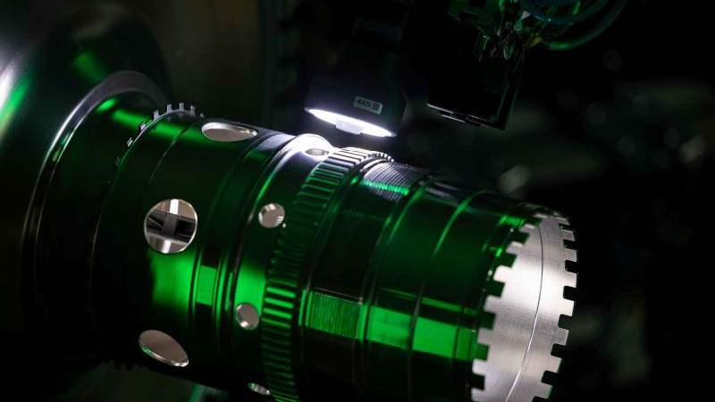

“Staring at the same part or feature for eight to twelve hours a day can make your head hurt,” says Sam Blazek, GE Aerospace services technology leader for white light inspection, who in the not-so-distant past inspected parts ‘caveman style’ — by hand, with a flashlight and a mirror. “You’re constantly twisting your head, eyes, and neck as you try to focus on each individual feature.” Whereas this robot inspector slips right into the disk’s interior.
By performing each inspection on a standard digital platform, white light robots ensure a consistent flow of extremely fine-grained information. They record the part’s serial number, assign a numerical value to any anomaly (whether dent, crack, corrosion, or fretting), and develop a consistent chronological narrative of the part that is instantly accessible in the cloud, indicating where repairs might make a part serviceable and providing a complete record of non-serviceable flaws.

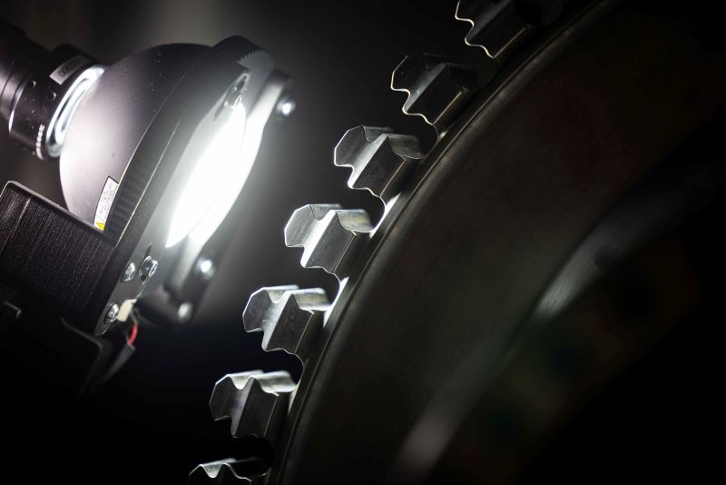

The first generation of white light robot technology captured images and digitally stitched them together. But line-scan cameras developed at GE Aerospace Research provide a higher-quality, video-like stream that replicates what a human eye can see, displayed on a computer monitor.
