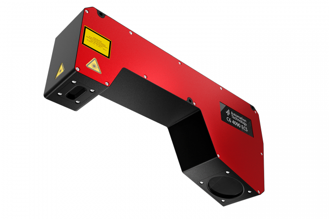

The ECS 4090 3D sensor from AT Sensors, with a field of view of 1020 mm, sets new standards in cost-efficient 3D sensor technology and impresses with the latest technology at an optimal price-performance ratio. Thanks to its particularly wide field of view of over one meter, the sensor is ideal for demanding applications in various industries where a high-performance solution is not required.
Whether it’s bin picking in robot guidance, inspection in the food industry, or package scanning in logistics – the ECS 4090 ensures highly precise measurement results with its high profile resolution of 4,096 points per profile, while also optimizing process control. The sensor offers decisive advantages, especially for large objects or extensive scanning areas, as it captures a larger area with a single shot. This reduces the need for additional sensors or complex motion control systems and increases efficiency and cost-effectiveness in production.
With a nominal working distance of 744 mm and a Z range of 700 mm, this ECS 4090 model reliably captures even complex surface structures. The X-resolution of 251 micrometers ensures detailed measurement data, while the high profile speed of 24 kHz enables rapid data capture. The sensor can be used without additional protective measures thanks to the 660 nm laser class 2M. It can also be easily integrated into existing systems thanks to support for standard interfaces such as GenICam and GigE Vision.
