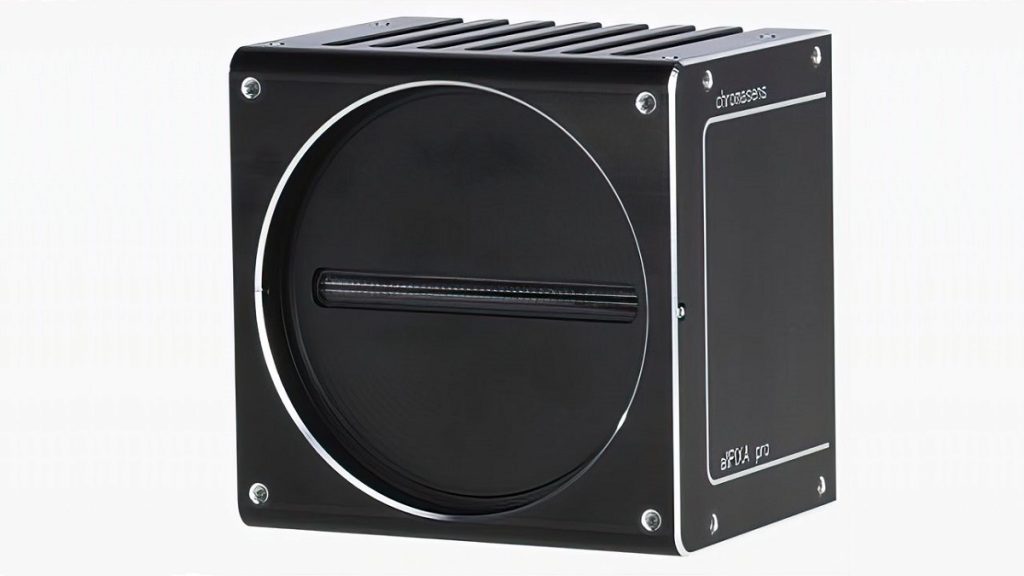

Allied Vision has announced the allPIXA pro 6000px, a Camera Link color linescan camera purpose-built for the relentless demands of high-speed machine vision inspection. With a 6000-pixel CCD 3-line RGB sensor, 34 kHz maximum line rate, and a spectral range spanning 400 nm to 1000 nm, the allPIXA pro 6000px captures every flaw, shade deviation, and surface anomaly, even on production lines that never stop moving.
Uncompromising Resolution at Production Speed
The allPIXA pro 6000px leverages a three-line CCD RGB sensor with 6000 pixels per line at a 10.00 µm × 10.00 µm pixel pitch. Operating over the Camera Link interface at a 85 MHz pixel clock, it builds continuous 2D images line by line with zero motion blur, whether the object races past a stationary camera or the camera traverses a static surface. Resolutions equivalent to thousands of dots per inch are achievable, unlocking defect detection at the sub-millimeter scale.

The allPIXA pro 6000px is housed in a compact 102 × 77 × 100 mm metal enclosure rated IP50 for protection against particulate ingress in factory environments. Its non-volatile flash memory ensures that calibration profiles, white balance settings, and gain configurations survive power cycles and system restarts, keeping production lines running and re-commissioning time to zero.
