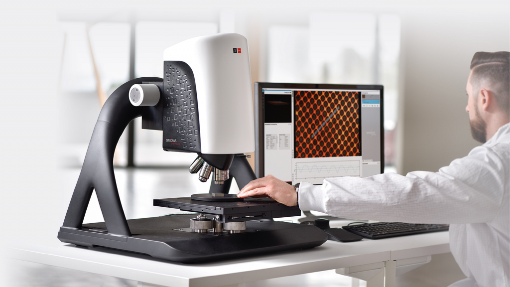

Even minor irregularities in surface finish can impact part performance – therefore manufacturers need to use a tool that measures surface finish to the nanometre. The Sensofar 3D optical surface profiler, for example, uses interferometry techniques for areal surface characterisation, as well as an optical design that makes it possible to double the field of view without compromising the resolution. By using a combination of Phase Shifting interferometry (PSI), Extended Phase Shifting Interferometry (ePSI) and Coherence Scanning Interferometry (CSI) techniques, manufacturers can use the profiler to measure a range of surface characteristics.
PSI is best for ultra-smooth and very flat, continuous surfaces, such as those on optical components. CSI is the most versatile mode, measuring smooth and rough surfaces with 1 nm resolution, and can also measure transparent layers with thicknesses from 1.5 to 100 microns. Meanwhile, ePSI which can be understood as a combination of PSI and CSI, is used for measuring smooth surfaces with structures, making it perfect for measuring features on wafers.
Interferometry has a high level of repeatability and accuracy and is faster than some confocal technologies, like laser confocals. By using this technique, engineers can produce topographies with a high number of measured data points, clearly showing the surface of intricate components.
