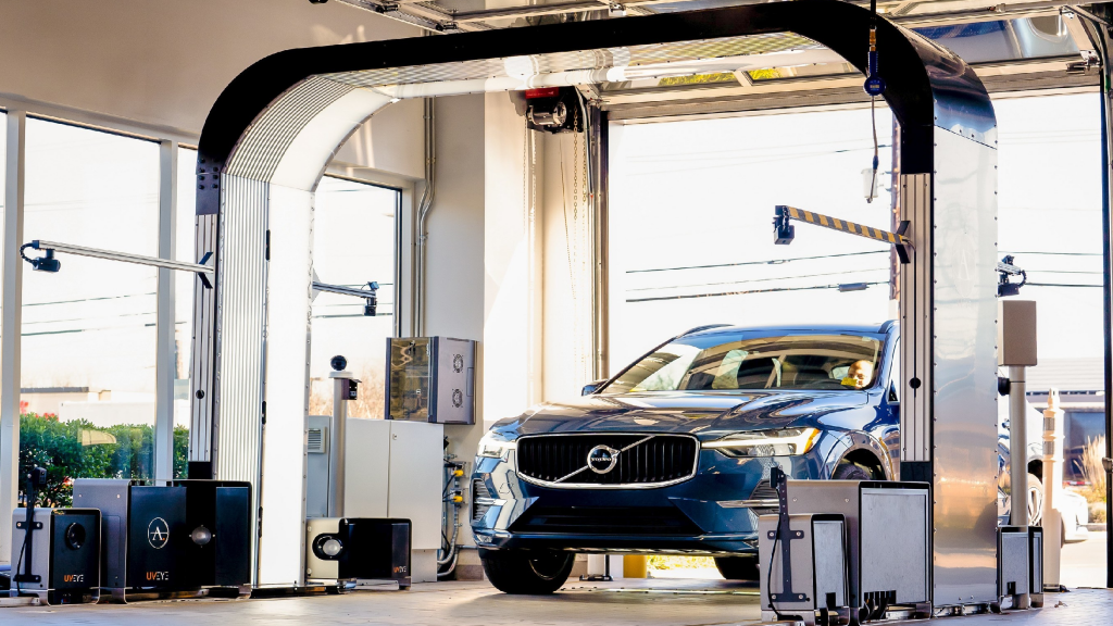

High-speed, camera-based systems from Israel-based UVeye utilize artificial-intelligence and machine-learning technologies to check tires, underbody components and vehicle exteriors for defects, missing parts and other safety-related issues.
 The automated vehicle inspection process takes seconds to complete and is significantly faster than time-consuming manual inspections, according to Rick Bryant, the vice president for sales operations at Volvo Car USA. This helps give retailers the ability to valuate trade-ins quickly, and cost-effectively, as well as check the condition of customer cars coming in for service.

Volvo retailers can install three basic UVeye inspection systems:
Helios – An underbody scanner that detects a wide range of problems from frame damage to oil leakage and corrosion.
Artemis – A tire system that quickly identifies tire brand, basic specifications, air pressure, tread depth, sidewall damage and even whether a vehicle’s tires are mismatched.
Atlas – A system that provides 360-degree scans of the exterior and detects damage such as dents, scratches and rust on critical components such as bumpers, mirrors, door locks, grilles and windows.
