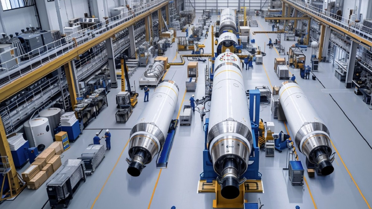

Four Sensor Families Driving Industry 4.0 Rocket Manufacturing
Sensors known as asset trackers monitor the availability, condition, and location of production equipment and resources, as well as key manufacturing processes, in real-time. Monitoring vibrations during processing provides valuable insights into product quality via process stability. GPS trackers enable complete traceability of parts and components on their way into the factories, during further processing, and on their way to final assembly. A fourth category of sensors tracks energy consumption during production, helping to keep the manufacturing – related CO₂ footprint as low as possible.
