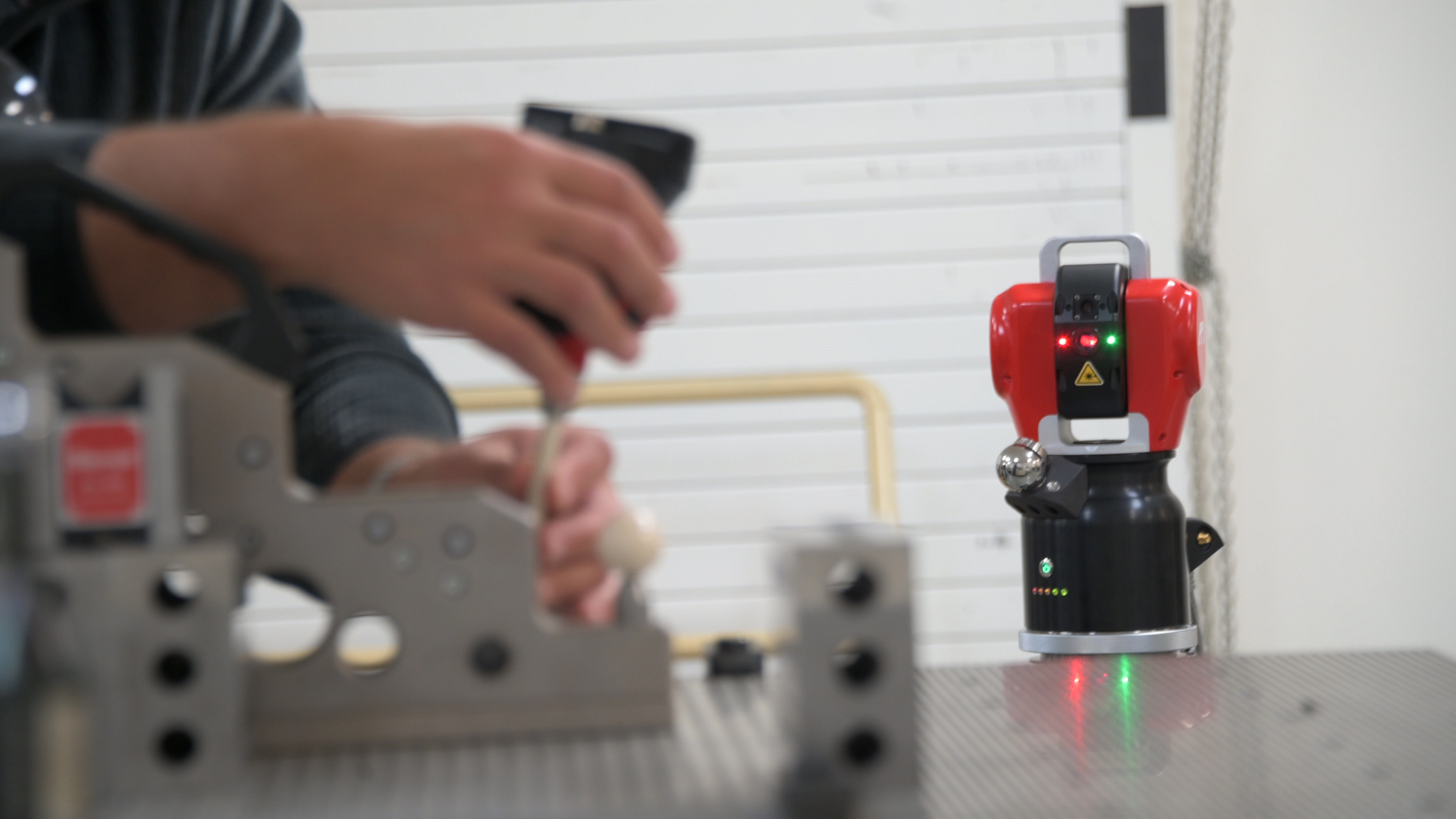

Automated Precision Inc. (API), a global leader in advanced metrology solutions, has announced the launch of their 6th generation Laser Tracker: The API Integrated Laser Tracker (iLT) represents the pinnacle of Laser Tracker technology refinement, engineered to be the most portable, user-friendly Laser Tracker ever designed and featuring several improvements over the previous generation.
Smallest and Lightest Laser Tracker Ever
iLT is the smallest and lightest Laser Tracker ever made. Weighing just 4.9kg, it reduces the weight of API’s Radian Laser Tracker line by 50%. Hot swappable batteries, on board controller, and Wi-Fi create a fully integrated unit that allows for cableless operation and the most portable measurements ever.
But while iLT is compact, it is also the most robust Laser Tracker API has ever produced. The Absolute Distance Measurement (ADM) laser provides data feedback faster than previous generations. And iLT’s improved 8MP camera with wide-angle iVision fast auto-lock ensures rapid recapture of beam loss and effortless usability in difficult to access line-of-sight measurements. The traditional tracker CPU has been upgraded to an AI-enhanced GPU that processes data and images faster for rapid results.
