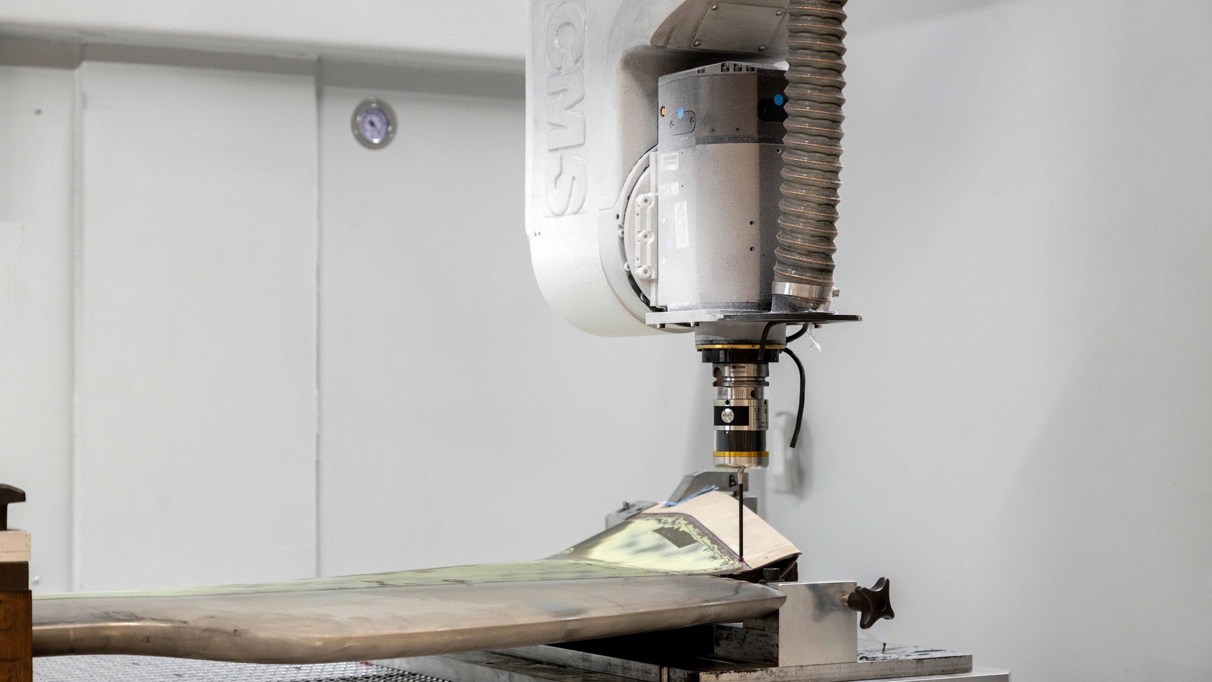

NC-PartLocator was introduced to solve Leonardo’s main challenge of accurately aligning the blades despite the unknown amounts of distortion. NC-PartLocator is different to traditional part alignment methods. The software uses 5-axis probing to measure a part on the machine and generate an accurate best fit alignment in 6-degrees of freedom.
Misalignment Errors Automatically Removed
Most importantly in Leonardo’s case, the software compensates for any discrepancy between the physical part location and the nominal machining program to show where the part ‘really is’ on the machine. The updated alignment is automatically uploaded to the controller and any misalignment errors are automatically removed.

It’s also aided David’s fixturing routine: “I designed the fixtures based on the fact that you move the machine to the part instead of moving the part. All I needed to do was hold the part in position so it could be probed. It didn’t matter that the blades were all variable and the position wasn’t correct as I knew NC-PartLocator would compensate for that. It’s night and day compared to traditional methods”.
