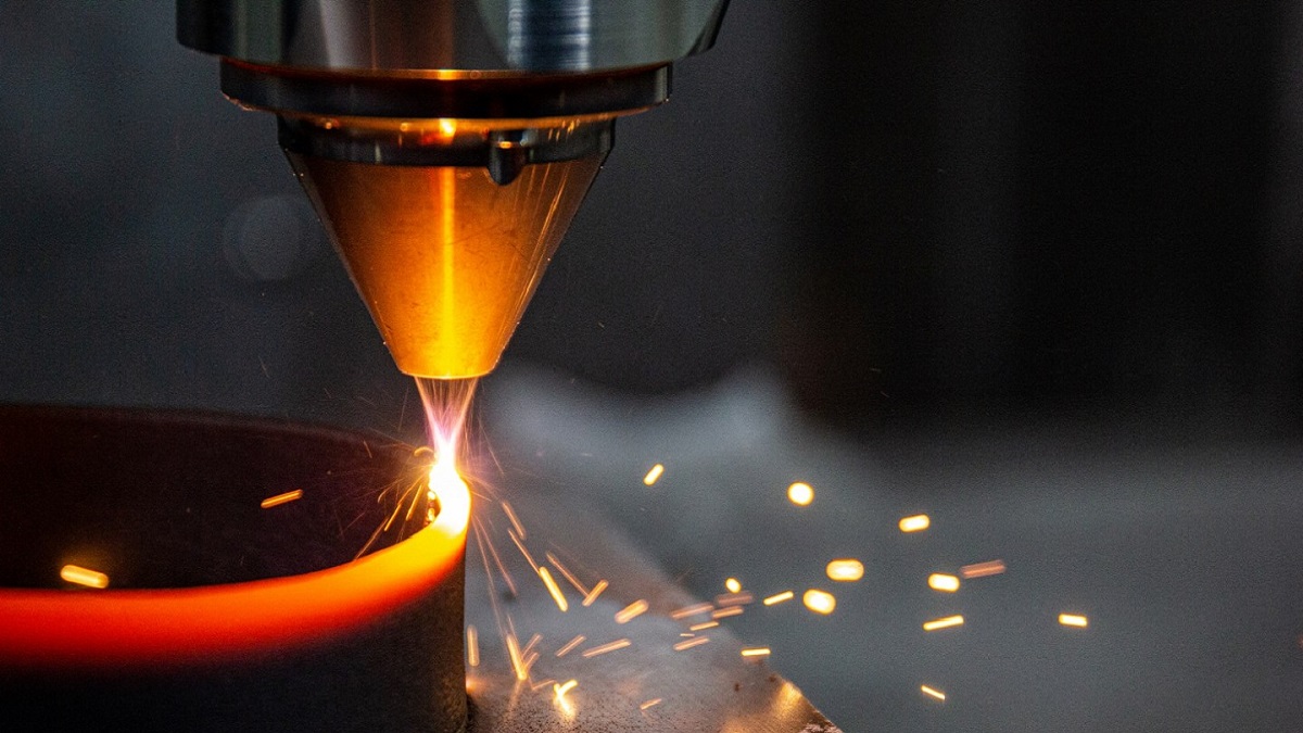

Makino’s task in the project was not only limited to the CNC hardware, but also to the process control, as this had to be completely redesigned. The challenge was to technically adapt the machine to high accelerations and to optimize the process control and machine kinematics in order to precisely control the interaction between the laser beam and the material.
The machine tool developed by the Makino subsidiary in Singapore achieves an effective feed speed of up to 30 meters per minute, which is a significant increase compared to conventional systems. This speed is especially advantageous when machining large and complex components, as it significantly reduces production time. The technical improvements lead to a consistently high quality of the end products and improved efficiency of the production process, which is particularly important for high-quality components in the aerospace and toolmaking industries.

Fraunhofer ILT contributed its extensive expertise in the field of laser-based manufacturing processes and brought its comprehensive infrastructure and specialized laboratory facilities to the project. Thanks to its decades of experience in process and component development for LMD, the institute made a decisive contribution to optimizing the process parameters for processing various materials and ultimately transferring the new technology to the industrial pilot customer toolcraft AG. This included adjusting the laser parameters, fine-tuning the powder feed and optimizing the motion control of the CNC machine.
“Optimizing the heat input is a critical aspect of the EHLA3D process,” explains renowned materials expert Min-Uh Ko. “The feed rate and powder gas jet play a crucial role in controlling the heat that is introduced into the material. By adjusting the feed rate and powder mass flows, we can precisely control the heat input, reduce the heat-affected zone and ensure uniform coating quality.”
According to Johannes Finger, the high build-up rate is a significant advance. “By using high feed rates and an optimized powder feed, we can achieve a considerably improved efficiency of the material application at the same or even higher precision. The build-up rate with HS-LMD can thus be significantly increased, which enhances the overall efficiency of the production process.”
