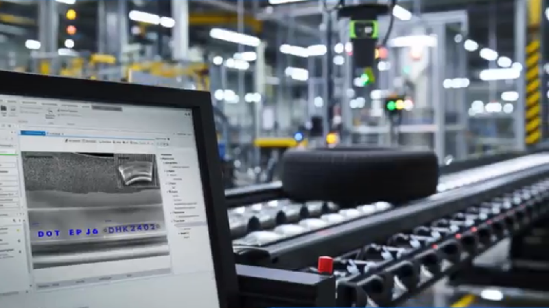

Zebra’s Aurora software suite with deep learning tools provides powerful visual inspection solutions for machine and line builders and engineers, programmers and data scientists in the automotive, electronics and semiconductor, food and beverage and packaging industries. The suite features no-code deep learning optical character recognition (OCR), drag and drop environments, and extensive libraries that allow users to create solutions to solve complex use cases that traditional rules-based systems struggle to address.

The deep-learning-based OCR tool uses a pre-trained deep neural network model to read characters, digits, punctuation marks and certain symbols without the need to specify or teach it specific fonts. The deep learning-based OCR tool includes string models and constraints to enable more robust and relevant reading.
