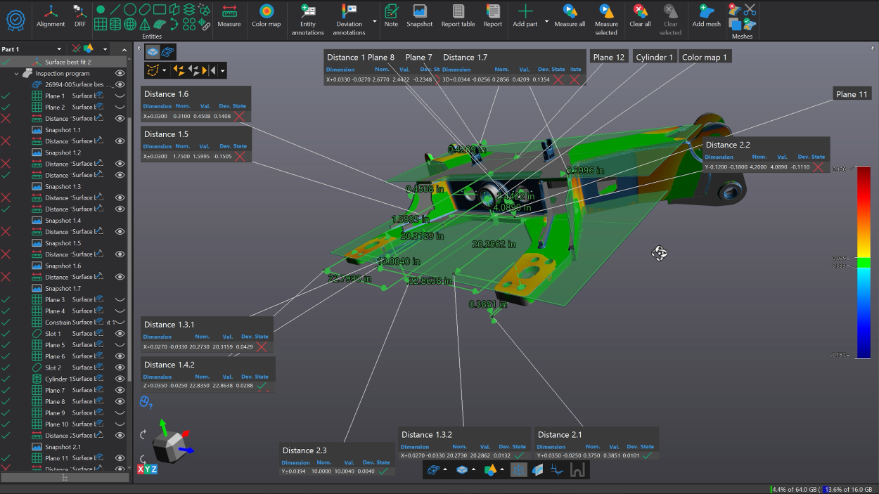

After evaluating several options, Xtreme Manufacturing selected the Creaform HandySCAN 3D|MAX Series for its ability to efficiently inspect multiple features on large weldments and generate detailed, inspection reports. One of the most appreciated capabilities was the ability to create an inspection file populated with all dimensions directly from the CAD model—ensuring a clear, one-to-one correlation between design intent and measurement results.

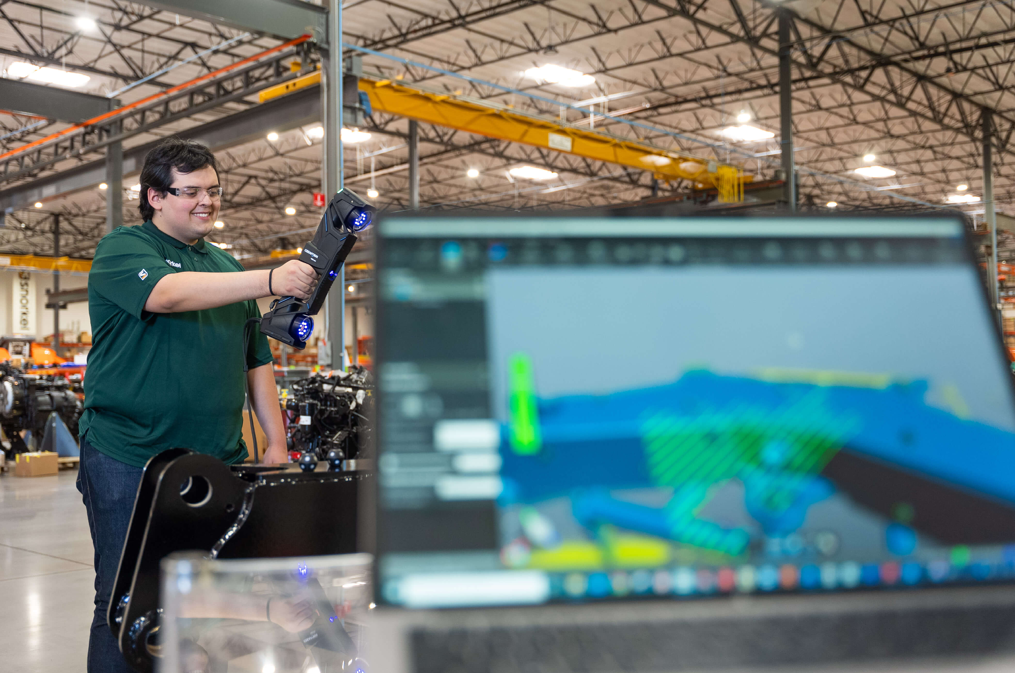

Moreover, integrating the HandySCAN 3D scanner into existing inspection workflows was effortless, and onboarding exceeded expectations. After just a few scans, the team quickly gained confidence using both the Creaform handheld 3D scanner and the Inspection software module of the Creaform Metrology Suite, making the implementation intuitive and seamless.

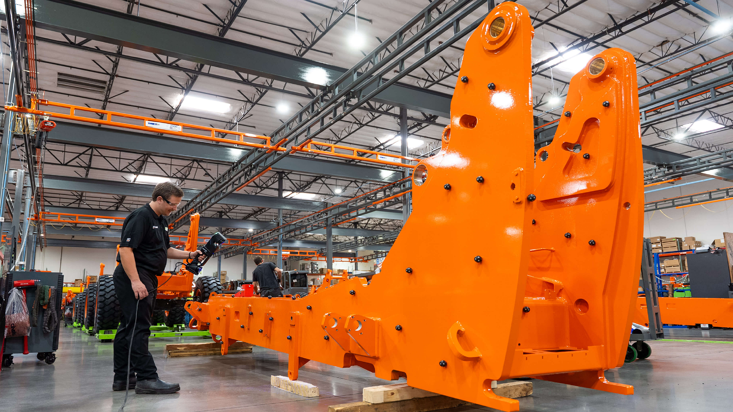

The adoption of Creaform’s 3D scanning technology quickly began to pay off. In one case, Xtreme Manufacturing noticed a rise in outrigger base weldments that could not be installed on the machines during assembly. Rather than risk further disruption, they proactively pulled all 30 units from inventory and scanned each one to identify defects before they reached the assembly line.
This approach allowed them to isolate the issue early and prevent repeated delays. Moving forward, their team now has the ability to stay ahead of quality issues by quickly scanning inventory parts whenever needed—ensuring they ‘feel the pain’ only once.
