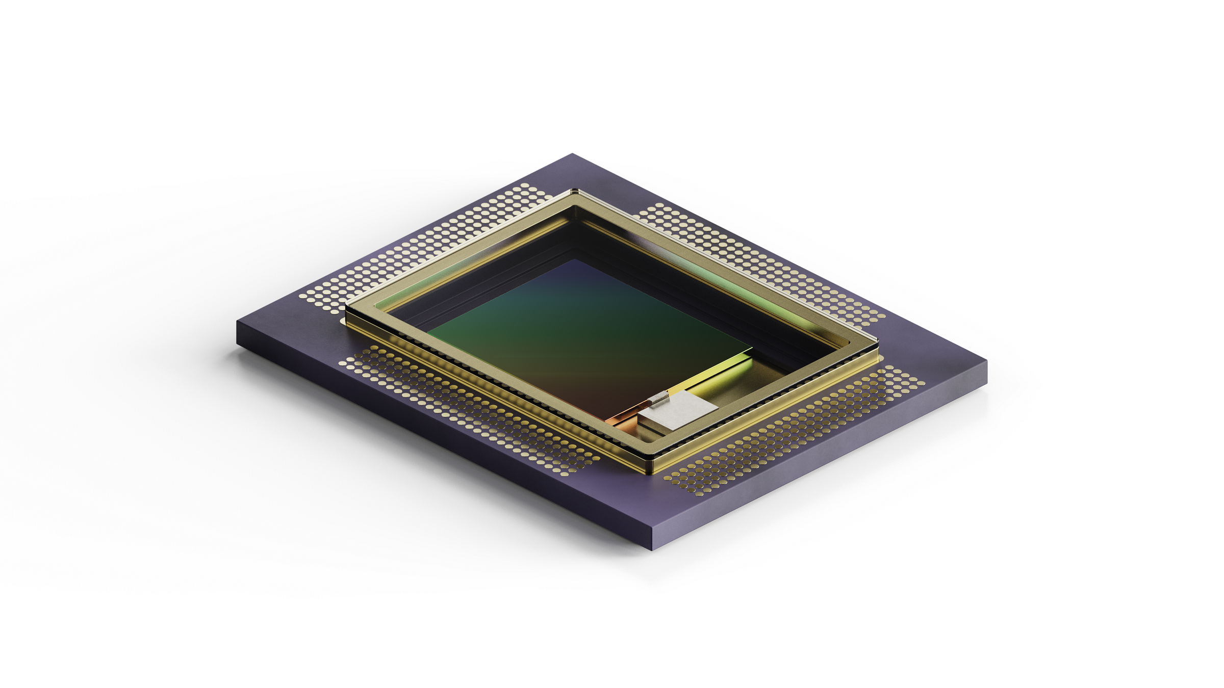

Leveraging Voyant’s proprietary Photonic Integrated Circuit (PIC), Helium offers camera-like simplicity and unmatched flexibility. Helium uses a dense two-dimensional photonic focal plane array with fully integrated 2D on-chip beam steering — eliminating all unreliable scanning methods: MEMS, mirrors, and resulting in no moving parts. The FMCW LiDAR chip leverages a two-dimensional array of surface emitters to create a fully solid-state LiDAR in an ultra-compact, rugged design. Helium also supports multi-sensor configurations, combining, for instance, a wide-FoV short-range and narrow-FoV long-range sensing in one system — delivering the most versatile and cost-effective LiDAR solution for advanced perception applications.

Field of view and range can be tailored with different lenses, and the platform scales from core module options to fully enclosed sensor. Helium is built on a 2D array of surface-emitting photonic antennas combined with a fixed lens and integrated electronics, forming a rugged module ideal for embedded perception.
