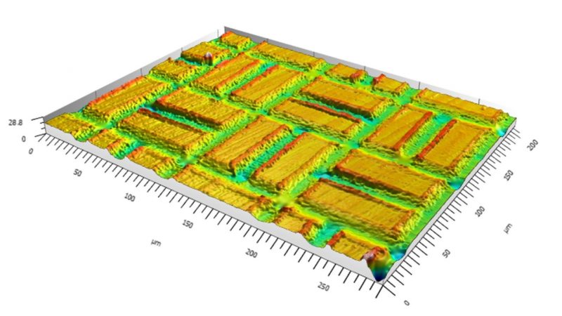

3D surface profile of an optically stamped microstructure: The deterministic basic pattern is created with stationary laser pulses and shows clearly defined reliefs with reproducible geometry.

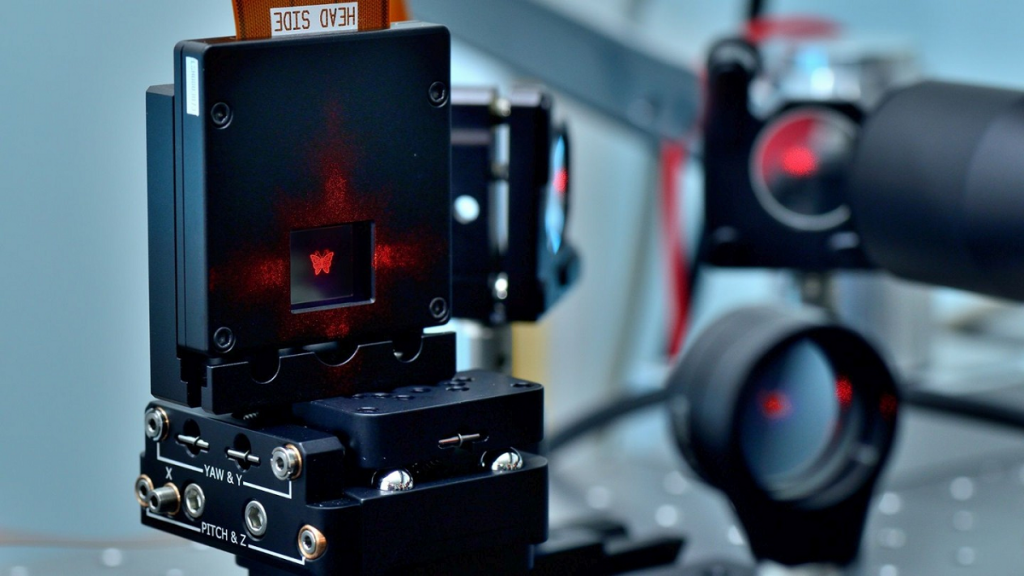

In optical stamping, the laser beam is not guided across the surface in a vector-based manner using scanner mirrors, as is usually the case, but is shaped into the desired structural pattern in a single step and transferred directly to the workpiece. The core component is an SLM with LCoS (Liquid Crystal on Silicon) technology. This reflective liquid crystal display changes the local refractive index with pixel precision, thereby modulating the phase front of the incident laser light. Thus, an initially round beam is transformed into a complex, freely selectable intensity profile.
