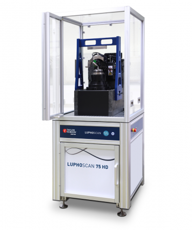

In a significant advancement for optical metrology, Taylor Hobson has unveiled the LUPHOScan 75 HD, an automated system that sets new benchmarks for speed, accuracy, and repeatability in non-contact 3D measurement of small lenses. Designed to address the rigorous demands of modern optics manufacturing, the instrument combines laboratory-grade precision with the efficiency required for high-volume production environments.
Automated Alignment for Maximum Throughput
At the heart of the LUPHOScan 75 HD is a fully automatic centering and leveling table, an innovation that removes the need for manual alignment and the operator skill traditionally required. This automation transforms a previously time-consuming and variable step into a simple, repeatable, single-click process. The result is unmatched consistency, with the full workflow from alignment to analysis completed in under 120 seconds, significantly boosting production throughput.

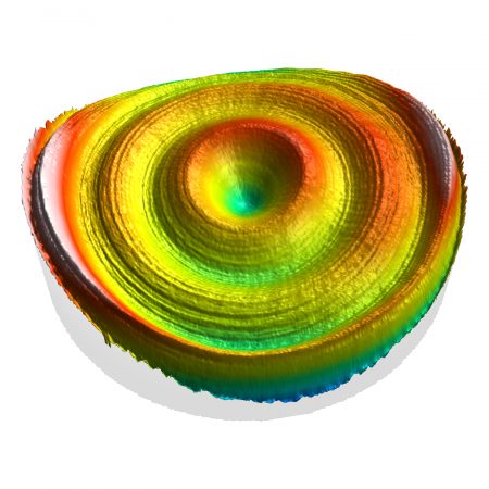

Exceptional Accuracy: Repeatability better than ≤ 30 nm PV (3σ).
Superior Stability: Power variation of ± 15 nm (3σ) and PV variation of ± 1.5 nm (3σ).

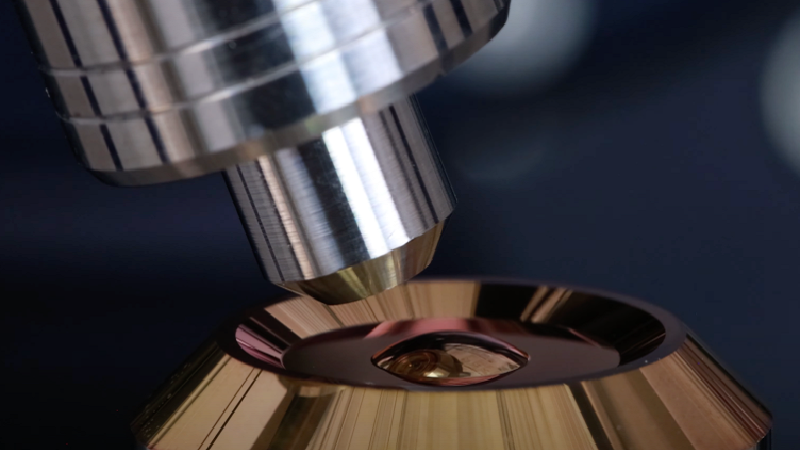

Equipped with an optimized probe and a large 7.5 mm working distance, the LUPHOScan 75 HD enables precise measurement of complex geometries. The system achieves this through a spiral scanning approach, producing a dense 3D point cloud. An air-bearing spindle ensures smooth object rotation, while linear stages control sensor movement. A rotary stage maintains the sensor’s alignment normal to the surface, even on steep slopes and profiles with inflection points.
