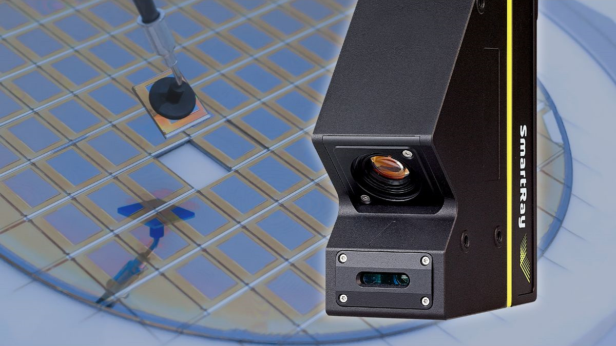

The new ECCO X 012 model represents a game-changing development for high-precision automated inspection in applications such as BGA (Ball Grid Array) inspection, PCBA (Printed Circuit Board Assembly) inspection and wafer inspection, as well as medical applications and other small Field of View (FOV) applications.
With a FOV of 12 mm at mid-field and up to 13 mm at far-field, and a measurement range of 6 mm, the ECCO X 012 creates unprecedented opportunities for more precision manufacturing operations to benefit from the evolution in 3D laser triangulation technology in the accurate inspection of smaller components.
The SmartRay sensor’s small FOV enables a lateral resolution of 2.7μm – 3.2µm. It has a scan rate of up to 40kHz and provides 4,096 3D points of resolution per profile, delivering up to 163 million points/sec.
Delivers 100% Metrology Grade Inspection
The sensor also offers the more intense Laser Class 3R as standard, which is more than 5 times stronger than the Class 2 laser, increasing the previously possible scan speed by reducing the exposure time. Consistent with the current models – the ECCO X 100 and the ECCO X 025 3D sensors – of the expanding SmartRay premium X series, the latest addition to the family delivers 100% inspection at metrology grade level to meet the highest inspection demands.
The ECCO X 012 combines the characteristic exceptional resolution and speed of the X series with a smaller FOV and MR to offer specific benefits for wafer inspection applications, including chip measuring, chip seating and die chipping, as well as in PCBA inspection, such as components alignment, chip height measurement, terminal pin bending and solder paste quality.
The sensor is also ideal for medical applications, with the capability to scan injection needles with varying diameters, and for inspecting the small shiny, metallic objects prevalent in electronics and semi-conductor wire bonding.
Measuring only 48 mm x 124,5 mm x 103 mm and weighing only 800g, the compact ECCO X 012 offers easy mounting onto existing inspection systems and simple integration into machines.
