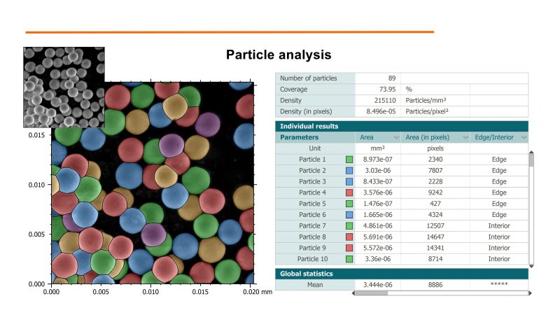

Explore Particles: Detect, quantify and measure particles, pores, or grains with precision. The module offers multiple segmentation methods, including thresholding and watershed, to overcome challenges in particle dispersion or sample preparation.
ÂEven touching particles can be separated and analyzed individually. Results include size, area, perimeter, shape descriptors and count distributions, with visual overlays that clearly display particle boundaries.

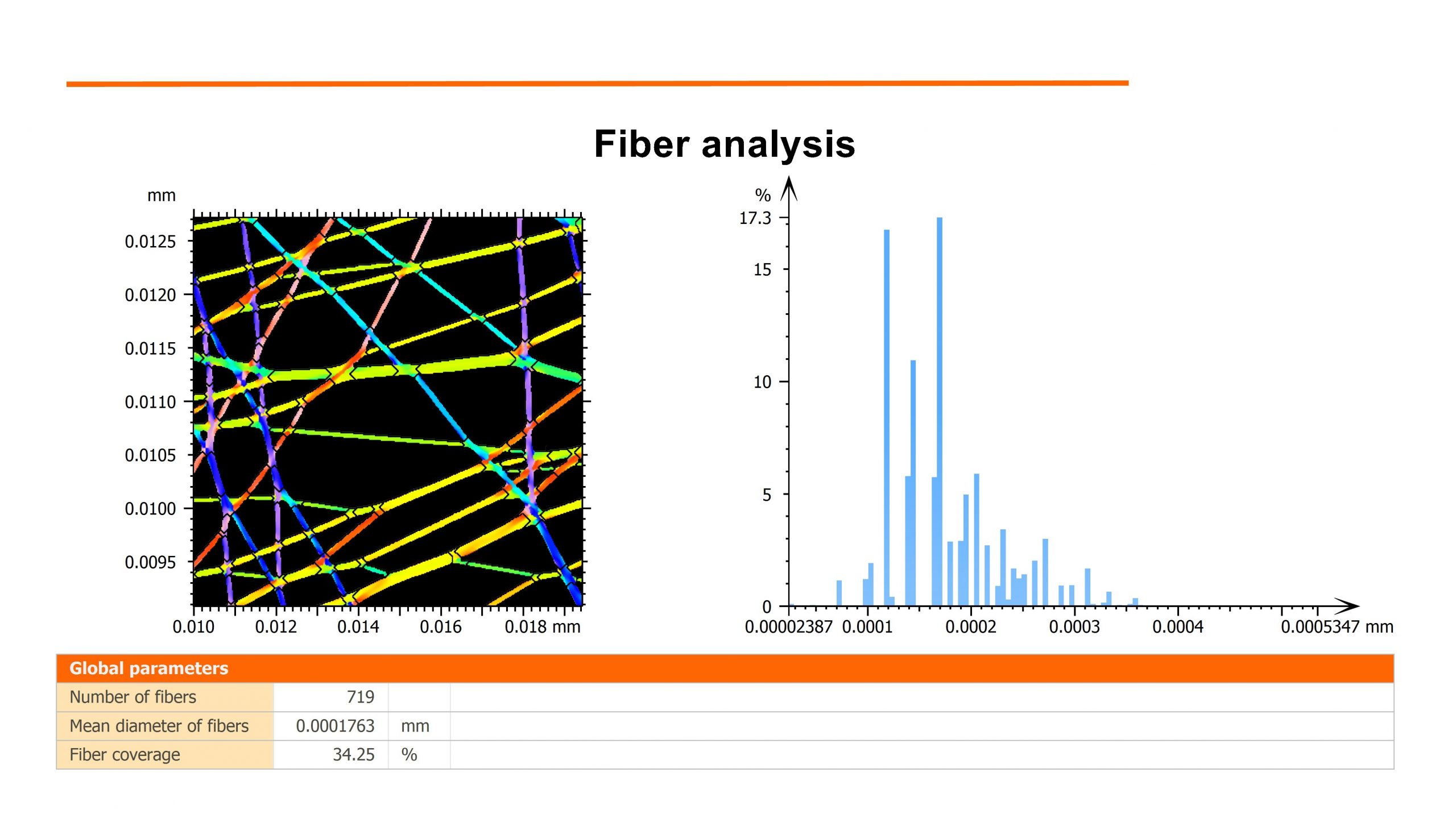

Explore Fibers: Specifically designed for fiber analysis, this module measures diameter, orientation and coverage and can accurately trace overlapping or touching fibers.
Orientation distributions and pore characteristics are automatically generated, providing valuable statistics for textiles, nonwovens, electrospun materials and more.

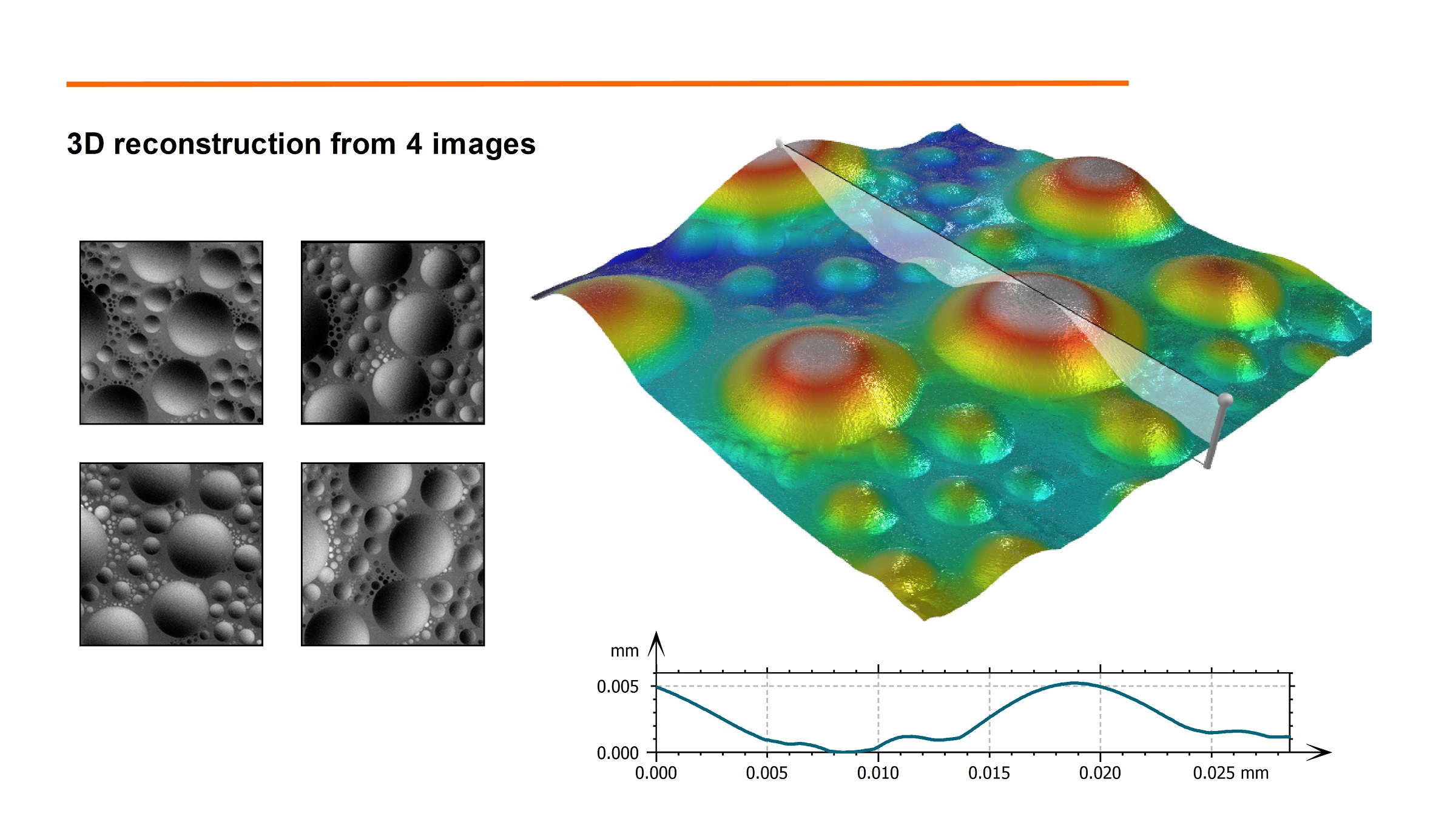

Explore 3D: Generate realistic 3D reconstructions and quantitative height maps directly from SEM images. The NANOS tabletop SEM features a unique eucentric stage tilt, enabling stereoscopy for both SE and BSE images, capabilities not typically available on other SEMs. Additionally, the four-quadrant BSE detector produces calibrated topography and height maps, while single-image rendering offers fast, visually compelling 3D visualizations.
