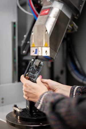

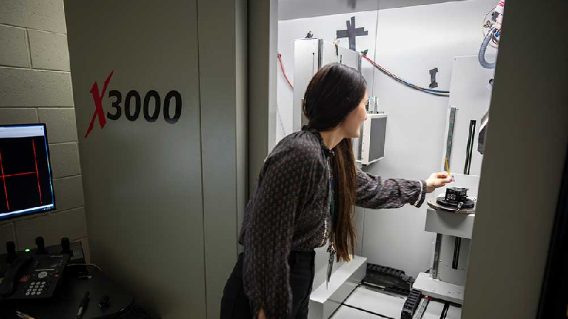

Noelle Collins sets up for an X-ray CT scan of a circuit board as part of the Non-Destructive Evaluation group at Sandia. (Photo by Craig Fritz)

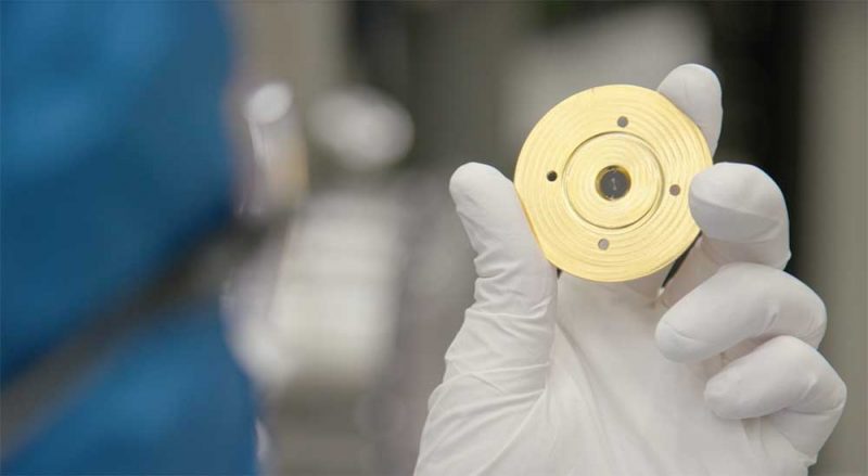

MULTI-METAL POWER — Electronics engineer Courtney Sovinec examines a packaged multi-patterned target used to create a new type of X-ray image. (Image by Vince Gasparich)
