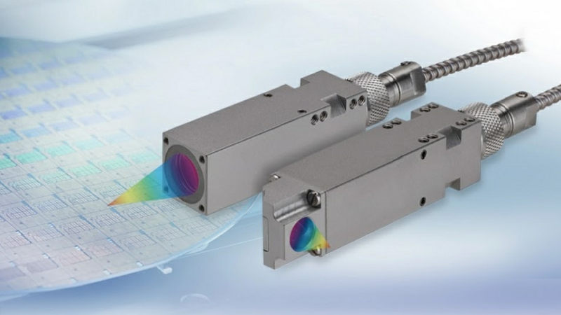

Due to their compact, robust design and various measuring range options, the confocalDT IFS2047-xHT/VAC series of high precision confocal stainless steel sensors are ideal for measurement tasks in very limited installation spaces. The installation space depth can be further reduced by using the optional 90-degree beam path version. This gives flexibility in sensor mounting for different installation scenarios.
The HT sensors can also be used in clean rooms and ultra-high vacuums (UHV). Due to their passive component design, the sensors do not emit any heat radiation into the environment. In addition, an adhesive-free design keeps outgassing to a minimum. Primary fields of application therefore include electronics, semiconductor, glass, medical technology and precision machine building.
