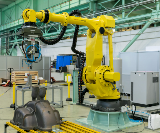

The solution developed by Aichi Sangyo integrates PushCorp’s Active Compliance Force Controller Device with METROL’s RC-K3X wireless touch probe to create an adaptive robotic machining cell capable of handling large, variably shaped castings.

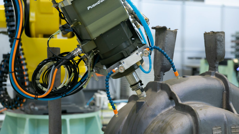

The PushCorp device features a servo spindle with BT shank compatibility and a sliding mechanism equipped with force, acceleration, and position sensors. This allows the system to maintain constant contact pressure, compensating automatically for variations in robot trajectory or workpiece geometry.
Mounted on an industrial robot, the PushCorp unit can perform a variety of processes – cutting, grinding, polishing – while continuously regulating force feedback. The addition of METROL’s touch probe introduces an essential metrological layer, enabling the robot to detect, measure, and adapt before beginning the machining operation.

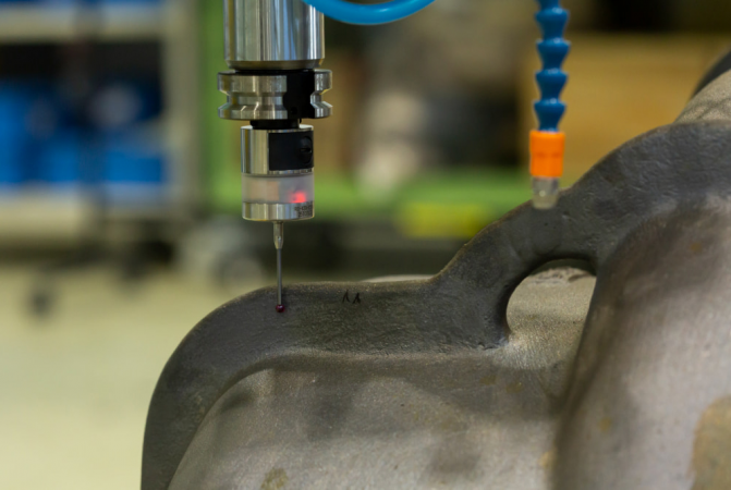

To solve this, Aichi Sangyo equipped the robot with METROL’s RC-K3X touch probe mounted in the PushCorp spindle’s BT shank. The robot first scans the workpiece surface by touching four key reference points. Based on the data, the system automatically calculates the workpiece origin and corrects its machining trajectory to account for positional deviations.

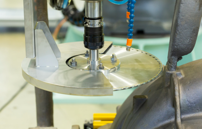

After measurement, the probe is replaced with a tip saw to cut off casting sprues – excess material remaining from the mold pouring process. The large iron casing in Aichi Sangyo’s example measured roughly one meter in all dimensions and housed the impeller of an LNG pump.

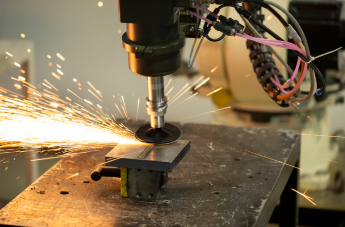

Once cutting is complete, the system automatically changes tools again, this time to an offset grinding wheel. A small machining allowance of about 10 mm is left to prevent overcutting. The robot then grinds and finishes the surface, maintaining optimal contact force through PushCorp’s active compliance control.
The result is a fully automated process – measuring, aligning, cutting, and finishing—all executed by a single robotic system.

Reliable Wireless Communication: Robotic arms have high mobility and multiple axes of rotation, making cable management with wired probes cumbersome and risky. The RC-K3X’s wireless architecture, based on METROL’s proprietary communication method, provides stable, interference-resistant data transmission with 1 μm (2σ) repeatability, even in challenging industrial environments.
Contact Measurement Accuracy: Laser-based measurement systems, while fast, can struggle with reflective or rough metal surfaces typical of castings. The contact-type touch probe ensures accuracy independent of surface sheen or environmental lighting, delivering consistent metrology-grade data.
This tactile feedback also enhances the teaching process. “When fine-tuning programs, we often need to operate from outside the safety fence,” Takemoto explains. “The RC-K3X makes it easy to confirm physical contact with the workpiece visually and confidently.”

One promising application is post-weld finishing. When metals are welded, the joint often leaves a raised ‘weld bead.’ Using the PushCorp device, the robot can grind these beads to achieve a mirror-smooth surface. However, by first measuring bead height and width with the RC-K3X, the system could automatically optimize pressing force, reducing cycle time and improving surface uniformity.
