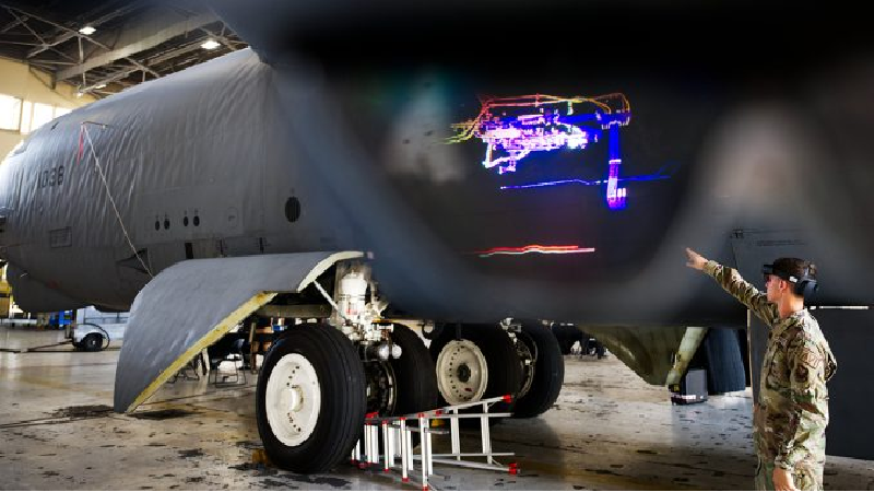

Northrop Grumman showcased AR capabilities, demonstrating how maintainers in remote environments could use AR-enabled glasses to collaborate with experts globally through the SEMPRE T network. Michael Hinkley, Northrop Grumman’s Sector Manager for Advanced Manufacturing, explained the security benefits: “The AR system allows maintainers to get real-time help without fear of unfriendly forces using the information against them.”
