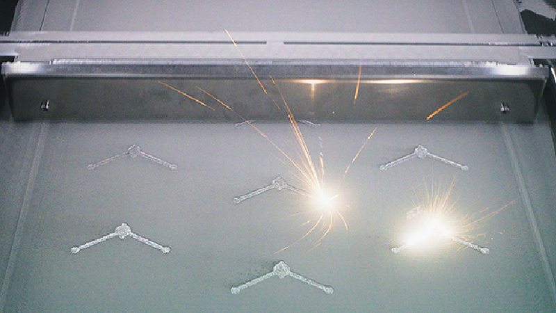

The 3DEXPERIENCE Powder Bed Machine Programmer (APB) Role provides a 3D interactive environment that enables manufacturing engineers to optimise powder bed fusion manufacturing techniques. This now includes Renishaw’s TEMPUS technology – an innovative scanning algorithm, exclusive to the RenAM 500 series of AM machines. It enables the laser to operate while the recoater is in motion, achieving time savings of up to nine seconds per build layer without compromising part quality. As a result, overall build times can be reduced by as much as 50%.

TEMPUS technology offers key productivity advantages to Renishaw’s market-leading range of metal additive manufacturing systems. “This technology allows the lasers to work continuously while the recoater supplies and positions each layer of powder, significantly increasing productivity and reducing the manufacturing cost per part,” said Matt Parkes, AM Strategic Development Manager at Renishaw.
“With TEMPUS technology, Renishaw has successfully solved an inefficiency in the traditional laser powder bed fusion (LPBF) production process, and paved the way for AM use in a broad range of applications where it wasn’t previously cost effective,” continued Parkes.
