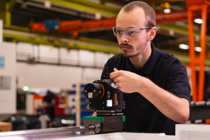

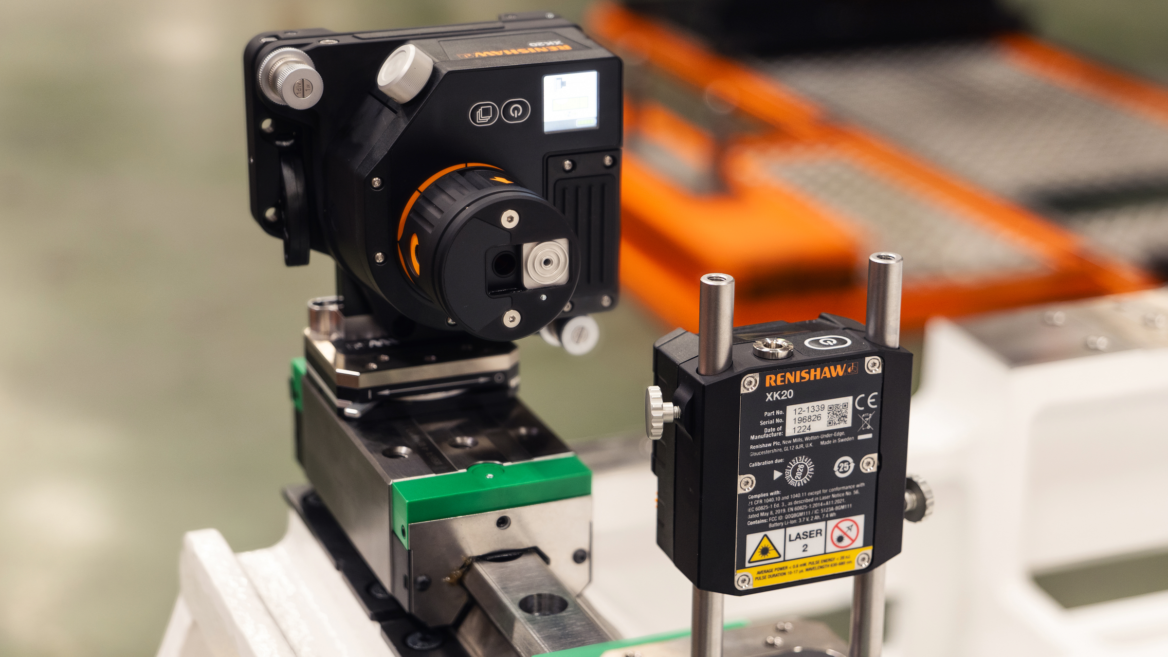

Renishaw has announced the developed the XK20 alignment laser system, its next generation system for machinery manufacturers that builds on the success of the award-winning XK10 alignment laser. The XK20 system combines innovative alignment laser technology with over 50 years of machine tool industry expertise. It streamlines and consolidates measurements, providing comprehensive build data for high performance machine tools, co-ordinate measuring machines and precision stages, whilst conforming to the latest international ISO standards.

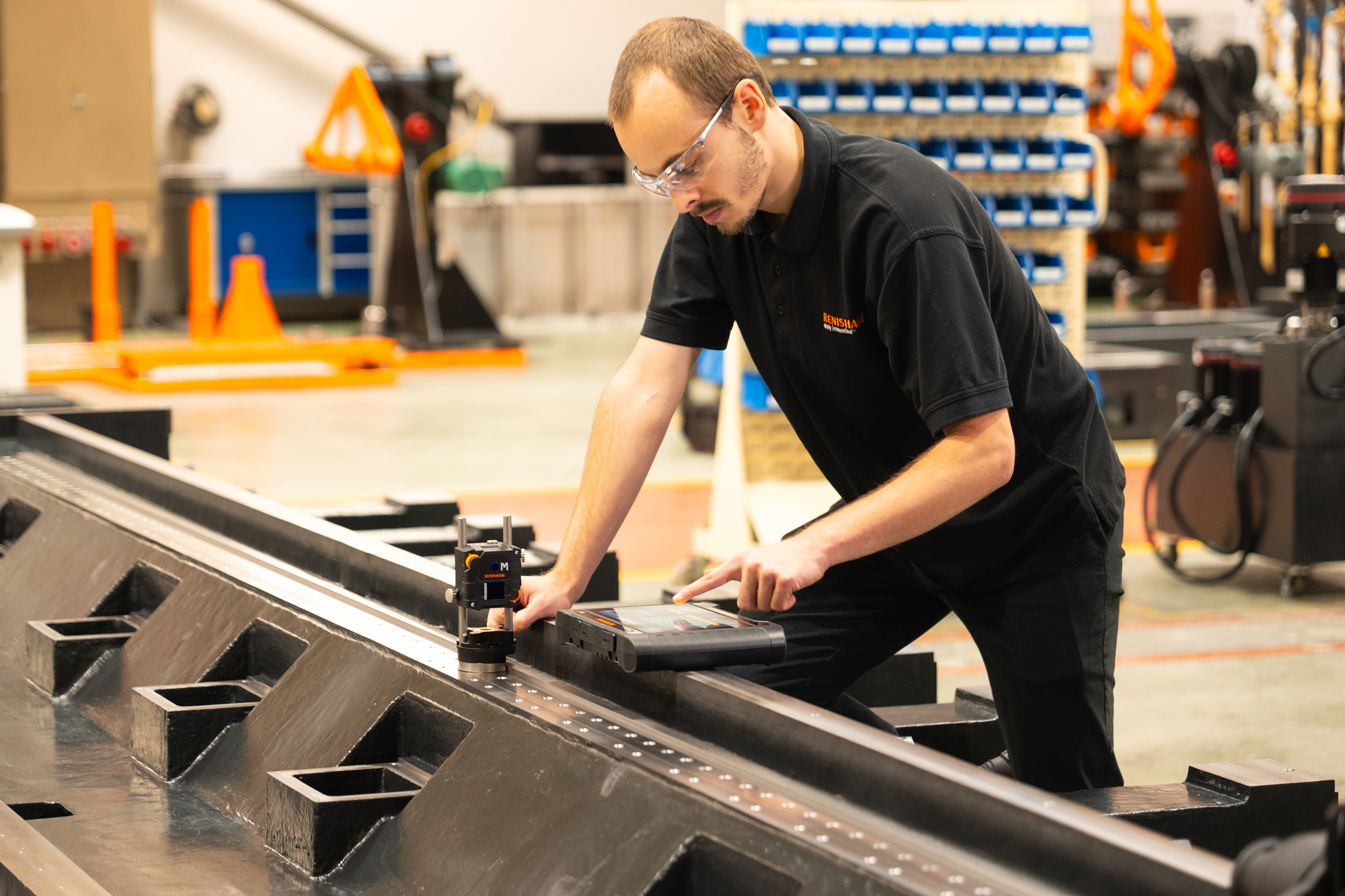

A standout feature of the new Renishaw XK20 system is the CARTO XK20 app, which combines the strength of Renishaw’s CARTO calibration software capabilities with a simple and intuitive user interface. The app’s built-in user guide, complete with images and animations, aids both skilled and unskilled machine tool builders and assembly operators. The CARTO XK20 app is available for Android devices or Renishaw’s rugged XK20 display unit.
The XK20 system’s advanced long range straightness measurement mode, available through the CARTO XK20 app, ensures guaranteed repeatability over unlimited axis lengths, making it ideal for large-scale applications. High accuracy parallelism and squareness measurements can also be performed on large machine tools, stages, and gantry machines, enhancing their precision and performance.
