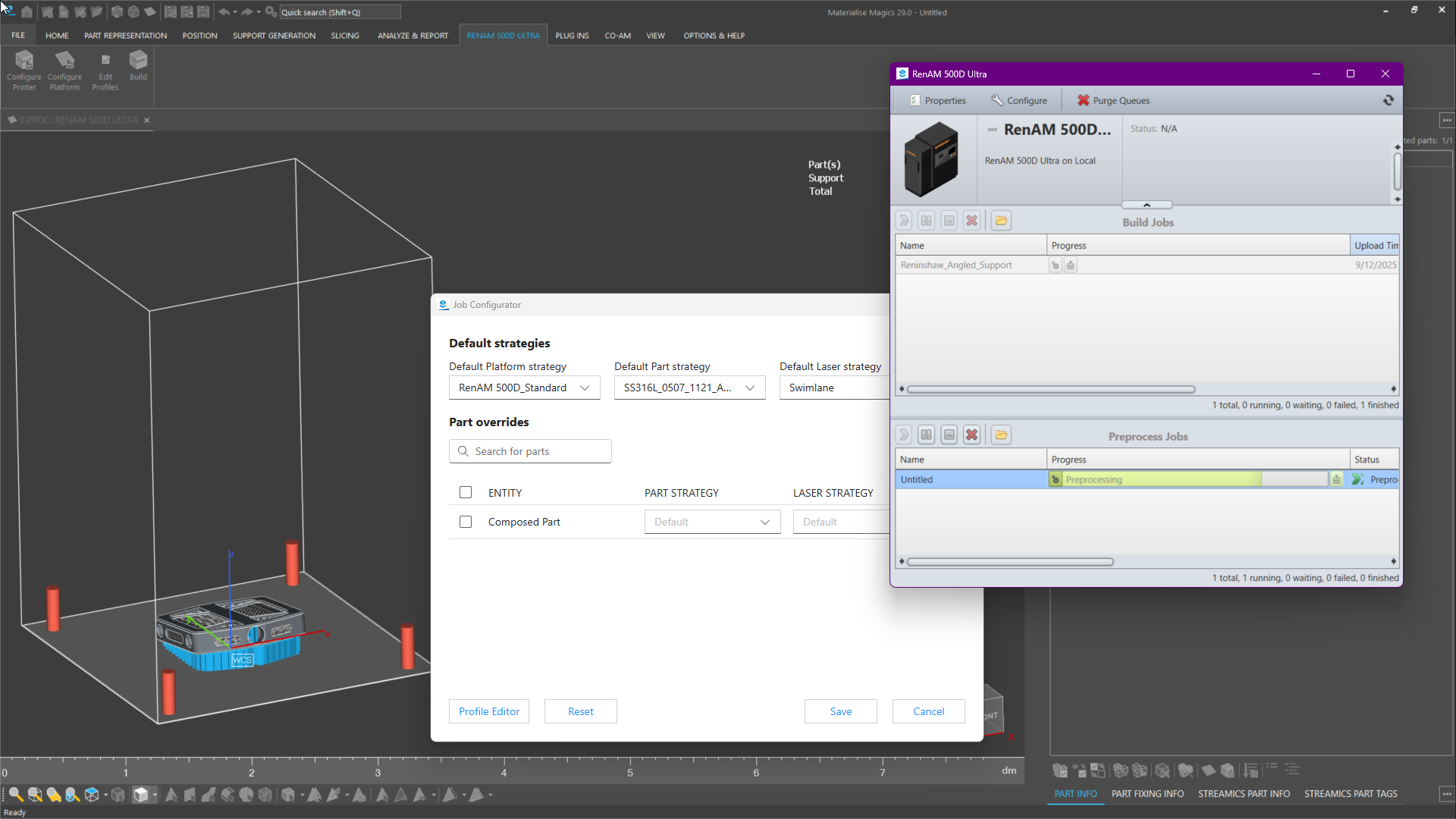

A key innovation is the Swim Lane feature, which intelligently distributes laser scanning across defined regions of the build platform. By preventing interference between lasers and managing overlap for full fusion, the system enhances part quality and consistency while reducing build times. Customers also benefit from integration with nTop implicit modelling workflows, making it easier to handle complex geometries and prepare jobs more efficiently.

To support quality assurance, NxG BP incorporates an integrated Inspector tool. This enables real-time verification of laser paths and job setup directly within the workflow, eliminating the need to switch between multiple software packages for quality checks. This data-driven approach allows users to identify and resolve potential issues before production begins. The processor is fully compatible with the complete RenAM machine range, extending the benefits of the new solution across Renishaw’s installed base.
