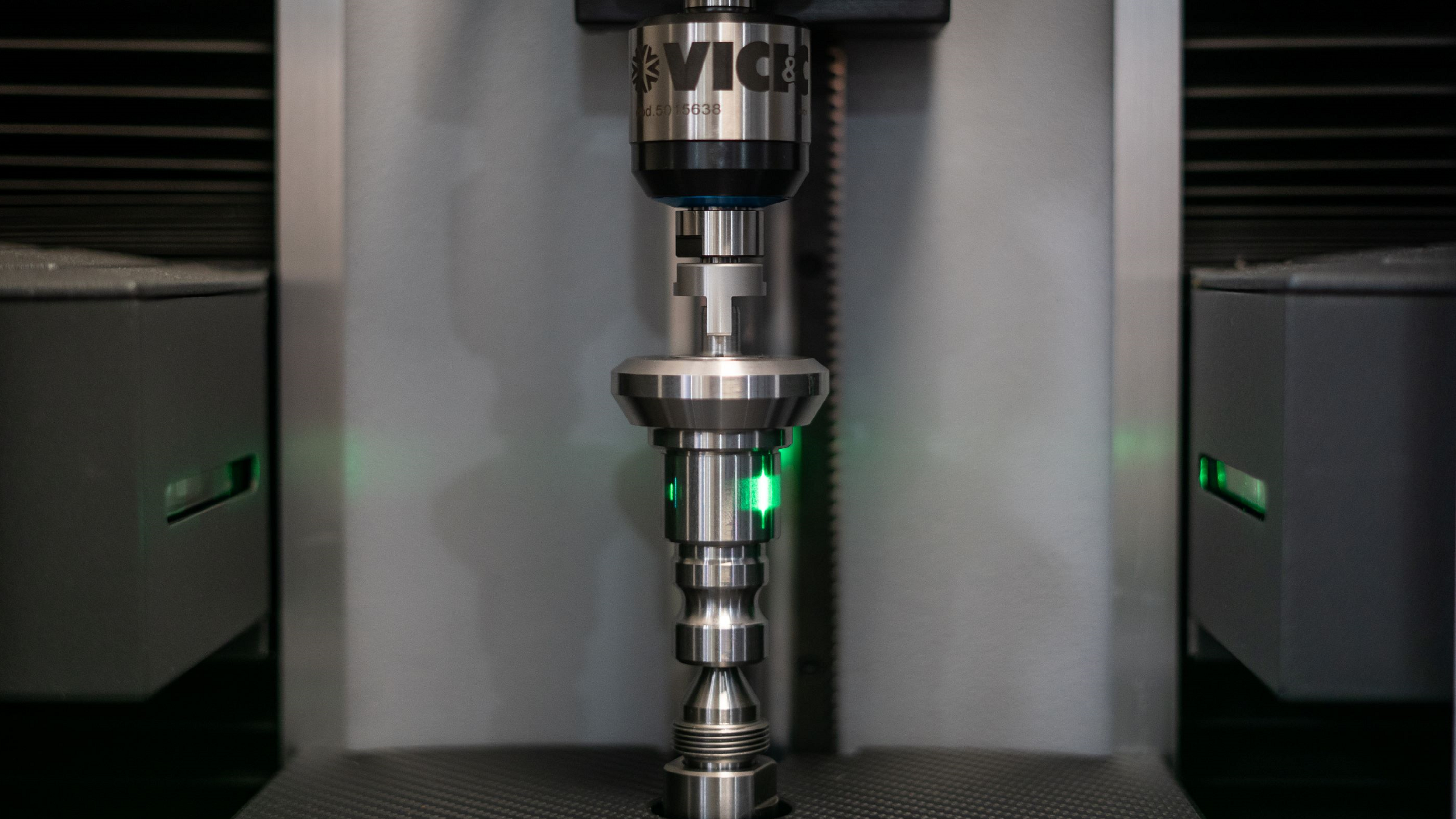

The Vici Vision optical scanners are designed to carry out complete form measurements on cylindrical components, such as Pailton’s shafts, ball pins and gears. The scanners perform critical checks such as sphere, taper, positional and even thread inspections.

Remarkably, these scanners can achieve 100 percent inspection of a component in as little as 12 seconds, providing a near instant analysis of a product within the machining cycle time. This rapid evaluation also allows Pailton to automate statistical process control (SPC), testing at regular intervals throughout a production run. Automating SPC enables Pailton to monitor production trends and pre-emptively address any deviations towards upper and lower specified limits (USL and LSL).
“We’ve also invested in bespoke fixturing for our ball pin CNC machines that enables all components to go directly to the scanners,” continued Jordan. “Parts are checked in-cycle, so we can see the trends and, if something starts to deviate, we can amend instantly, maintaining our nominal values. We can also access our historic data to provide greater traceability,” continued Jordan. “Should we ever need to review a component from a previous batch of steering ball joints, for example, the data from the scanners will have been stored, so we have full confidence that the part was within tolerances, evidenced by the measurement results for that batch.”
