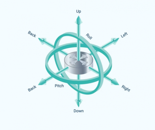

Why have 6-DoF force/torque sensors become essential in modern robotics?
Robots can no longer rely solely on vision or pre-programmed trajectories. They need to sense and adapt in real time. A 6-DoF sensor can simultaneously measure three forces and three torques, giving robots a true sense of touch. This physical intelligence is critical for collaborative robots, adaptive logistics, and even surgical robotics.

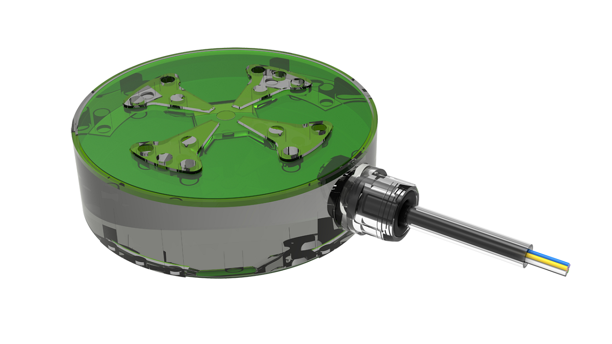

Precision is in HBK’s DNA. We rely on high-sensitivity strain gauges, combined with our proprietary calibration methods. The result is sub-millisecond latency, < 1% crosstalk, and durability proven over millions of load cycles. Many sensors are ‘components’; HBK delivers industrial-grade, fully calibrated solutions ready to integrate into demanding environments.
How do you collaborate with OEMs on customised sensor design?
It’s a co-engineering process; we start by analysing OEM requirements – mechanical geometry, payload, environment and communication protocol. Then we adapt the sensor design – form factor, embedded electronics and software interface. Finally, we validate it in real operating conditions. The key is delivering a sensor that fits seamlessly into the robot, without compromising on accuracy, robustness, or size.
