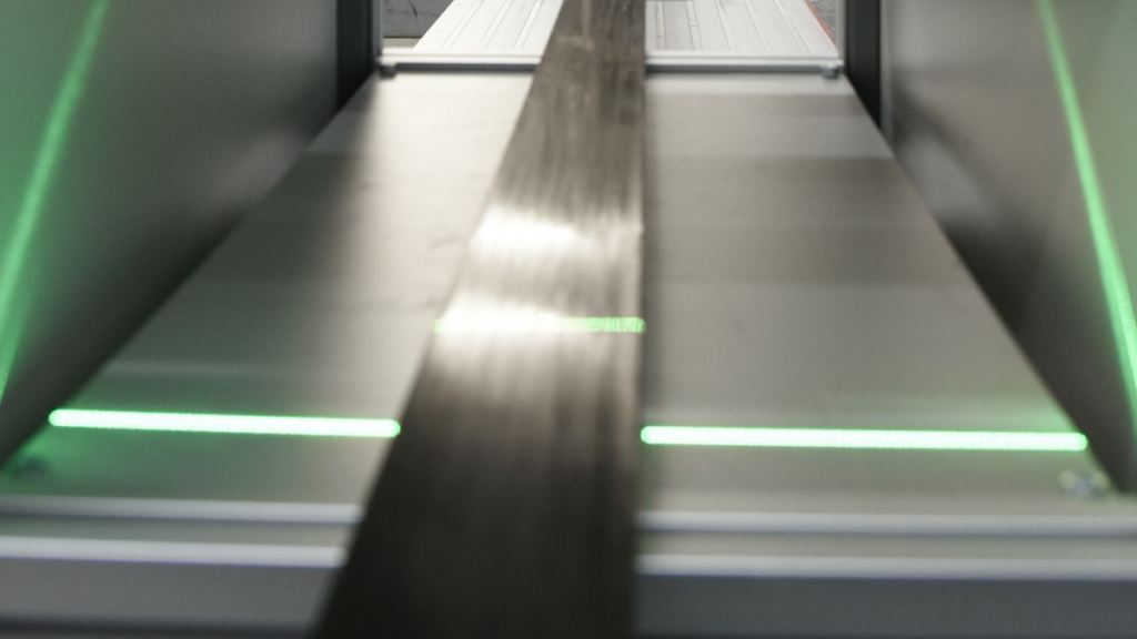

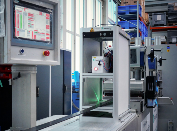

Fiber‑reinforced plastic profiles serve as key components in lightweight construction. Manufacturers typically produce them using pultrusion, a process that offers cost advantages but often introduces quality uncertainties in practice, especially with changing profile geometries or small batch sizes. Fraunhofer AZOM contributes expertise in optical surface metrology and AI‑based image analysis. The solution developed in the project, SURFinloop, uses low‑cost scattering sensors that continuously record surface data and compares it with digital reference models known as digital twins. Modular software evaluates the data and detects geometric tolerance deviations with high precision. The system then feeds this information directly back into the production process in a closed loop.
Technology for Small and Medium-Sized Enterprises
“Existing systems for quality monitoring in pultrusion are either too expensive or too complex to implement,” explains Alexander Kabardiadi‑Virkovski, project manager at Fraunhofer AZOM. “SURFinloop addresses the needs of small and medium‑sized enterprises.” The demonstrator detects deviations of less than 100 micrometers at production speeds of up to two meters per minute. Training the software takes less than one hour. Companies can implement the measurement technology for only a few thousand euros per system – a decisive advantage in cost‑sensitive industries such as automotive manufacturing or wind energy. The system adapts to different production lines and scales to a range of component geometries.
