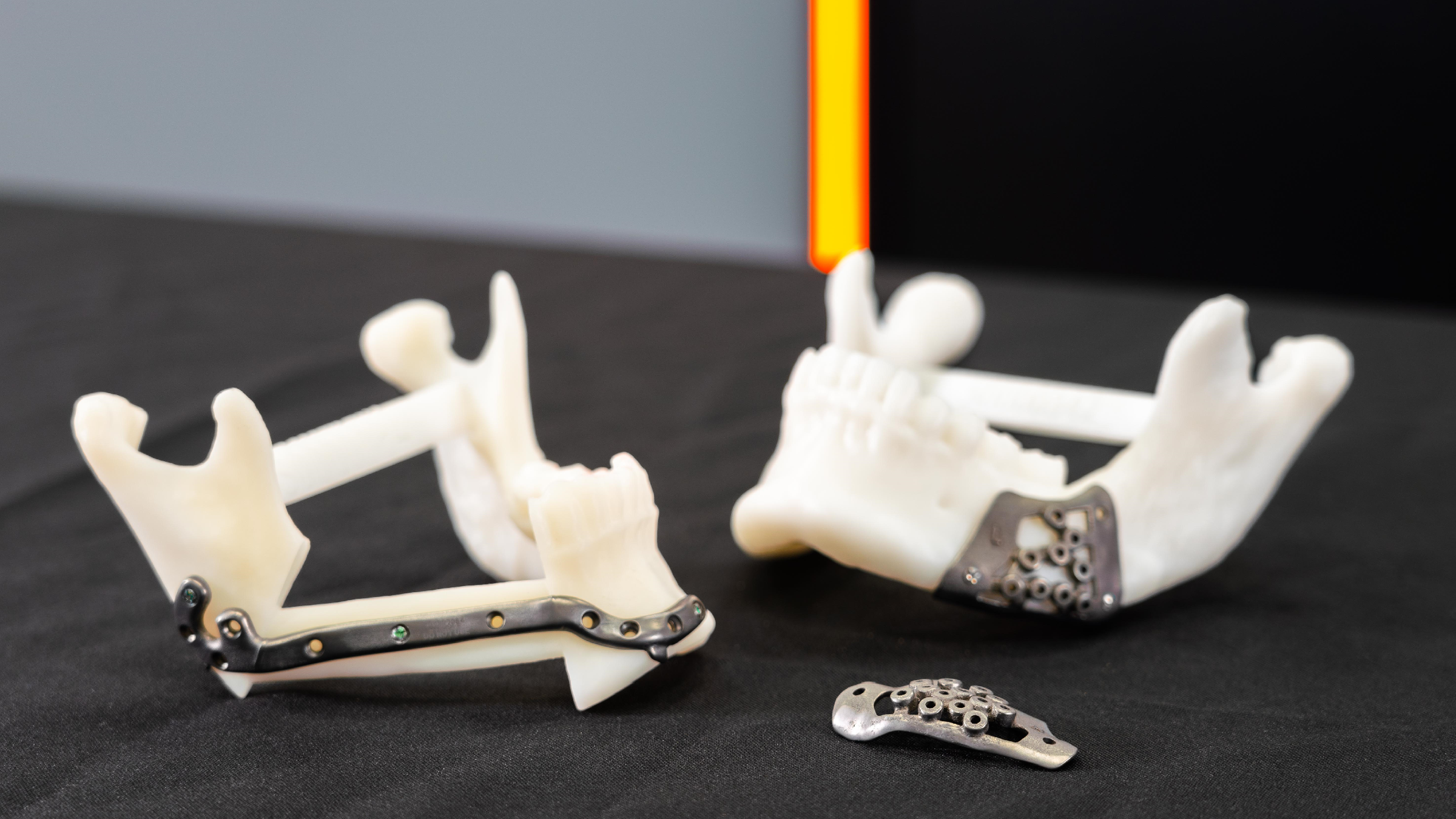

Medical manufacturers were early adopters of AM to develop patient specific parts with complex geometries at low volume. As AM technology develops, more medical manufacturers are considering how they can now implement it into mass manufacturing.
