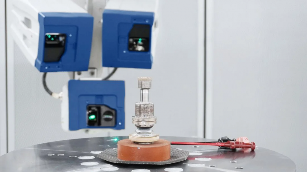

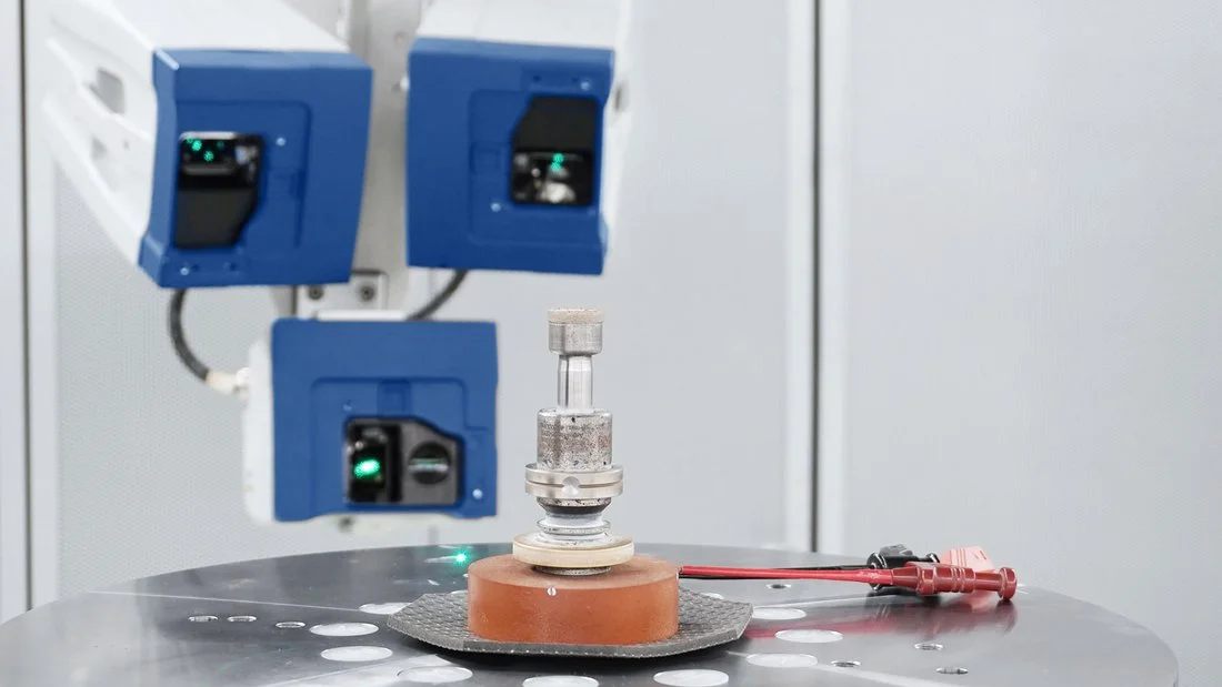

Only an optimal selection of all control variables leads to a surface that meets all the requirements for high-precision optics. In order to investigate the machine dynamics of the 5-axis CNC machine used to produce the flat-form surfaces by ultrasonic-assisted grinding and to identify the best possible machine setting, it is helpful to carry out a vibration analysis using laser Doppler vibrometry and to analyze the surface texture of the machined sample using white light interferometry.

Vibration analysis is useful both when the machine is at a standstill and in operation. When the machine is at a standstill, the natural resonances of the machine components are determined by exciting various machine components with a modal hammer in order to prevent unfavorably selected tool speeds and ultrasonic frequencies from exciting the natural resonance frequencies of these components and leading to undesirable vibrations during the production process and thus negatively influencing the surface quality of the finished product.
During machine operation, vibration analyses can be carried out directly during workpiece processing. Non-contact vibrometers can also be used to measure the rotating tool during the operation of machine components. Non-contact measurements on the workpiece during operation are also possible. Such operating vibration analyses reveal effects that remain undetected when the machine is at a standstill.
For example, the temperature compensation built into the CNC machine causes steps of the order of 1 µm to form on the surface at intervals of one second. The distance between two steps is linked to the feed rate of the tool by the periodic repetition of the temperature compensation. As stated by the AI model, this leads to the important insight that the temperature compensation of the CNC machine can also be disadvantageous and may be better left switched off.
In order to investigate machine vibrations during workpiece machining and their effects on surface roughness, the laser beam used for optical vibration measurement is deflected in such a way that measurements can be taken directly on the underside of the workpiece during tool engagement. Detailed images of the surface structure were used to establish a direct correlation between the distance or spatial frequency of machining marks on the resulting workpiece surface and the grinding process parameters of speed and feed rate.
