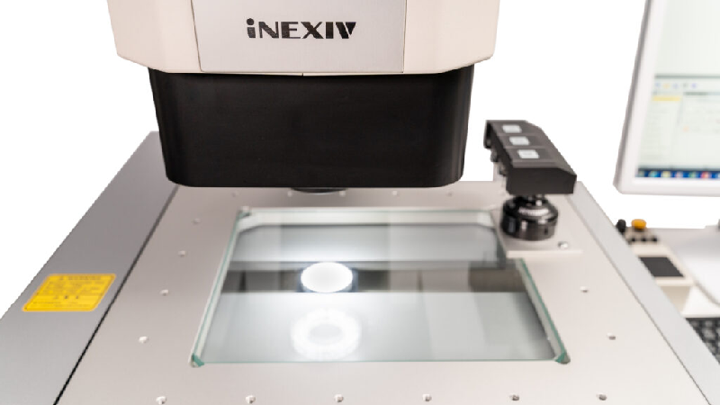

The company’s modern injection moulding processes required a more sophisticated approach. The solution came through collaboration with QControl who recommended the iNEXIV VMA video measuring system. This non-contact optical system offers high-speed measurement capabilities alongside unprecedented accuracy. Its multisensory technology combines video and laser, enabling precise 3D analysis of even the most intricate components.
Nikon’s iNEXIV VMA key features and benefits include:
- X, Y, Z accuracy up to 2μm.
- Automated measurements of multiple parts at the highest speed in the industry.
- Built-in laser for measuring and copying the height profile in Z, with an accuracy of 3μm.
- 126x magnification, large 50mm depth of focus and perimeter LED lighting for detailed measurements.
- Advanced AutoMeasure software with CAD-to-Part comparison, offline programming and shape analysis.
For Kalfoplast, the iNEXIV system‘s key advantage is its remarkable speed compared to traditional CMM contact methods while maintaining precision in measuring complex dimensions and geometric tolerances. The system’s advanced optical capabilities are particularly suited to Kalfoplast’s products, whose soft surfaces and intricate microstructures demand sophisticated lighting and identification tools.
